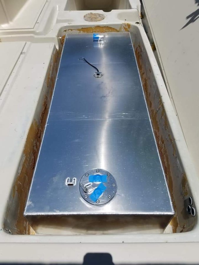

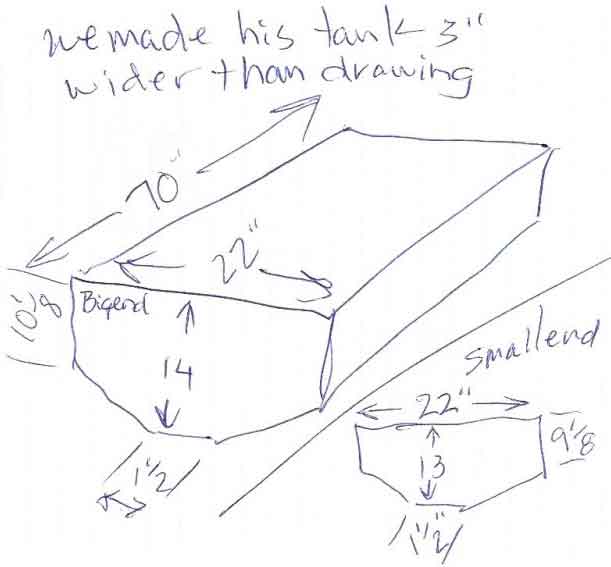

A gentleman has a custom 85-gallon fuel tank made up for his [1987--always use four digits for years] OUTRAGE 20. The tank fits in the fuel tank cavity space with room to spare. He achieved [the increase in volume capacity to 85-gallons from the usual 77-gallons] by making the entire tank 3-inches wider than normal.
Q1: is the fuel tank cavity space in the classic OUTRAGE 20 the same as in the classic OUTRAGE 22?
Q2: based on dimensions [apparently the dimensions shown below in a rough sketch] would a fuel tank of those dimension fit in the fuel tank cavity of an OUTRAGE 22?
Q3; does not using any foam to retain the fuel tank in the fuel tank cavity hurt the structure that holds the tank in place?

I recently replaced the fuel tank in my 1989 Revenge 22 which utilizes the same hull as an 1989 Outrage 22. The dimensions you show in the sketch for the 85 gallon tank are almost the same dimensions as the 77 gallon tank that Florida Marine Tanks fabricated for my Revenge 22. Your sketch illustrates the height at the smaller end as 9-1/8-inch and 13-inch where mine is 9-7/8-inch and 12-7/8-inch. The height at the big end on your sketch is 10-1/8-inch and 14-inch, and mine is 10-3/4-inch and 13-3/4-inch. All other dimensions are the same. That should answer your first and second questions.
For your third question: not using foam has no effect on the tank cavity structure. Foam was only used to keep the tank from moving. I supported my tank by 1/4-inch rubber strips bonded by 3M5200 at 12-inch spacing transversely along the bottom of the tank. I also used synthetic wood to block the sides of the tank from moving, and they are also bonded with 3M5200. The OEM aluminum bars across the top of the tank were also reused.
Florida Marine Tanks is the original manufacture of the fuel tanks in the classic Boston Whalers.
You have a comment in the sketch indicating that the 85-gallon tank is 3-inches wider then the drawing. I am assuming you are asking if a 25-inch-wide fuel tank would fit in the cavity. The answer os yes. I never did measure the width of the tank cavity but as I remember, there was approximately 4-inches of clearance on both sides.
Answer - Yes
Q2: based on dimensions [apparently the dimensions shown above in a rough sketch] would a fuel tank of those dimension fit in the fuel tank cavity of an OUTRAGE 22?
Answer - See DB's answer above.
Answer - The foam is what keeps the tank from moving. Using blocking around the sides of the tank instead of foam will achieve the same desired results.
