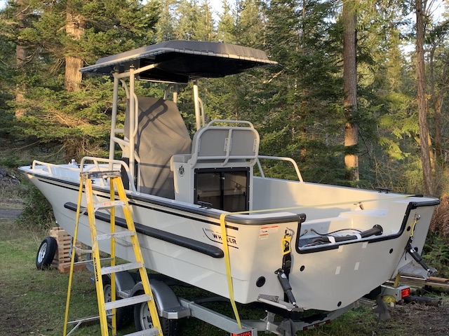

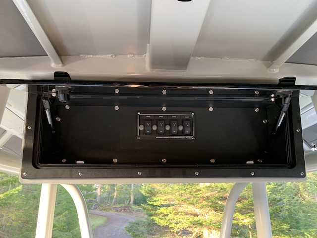

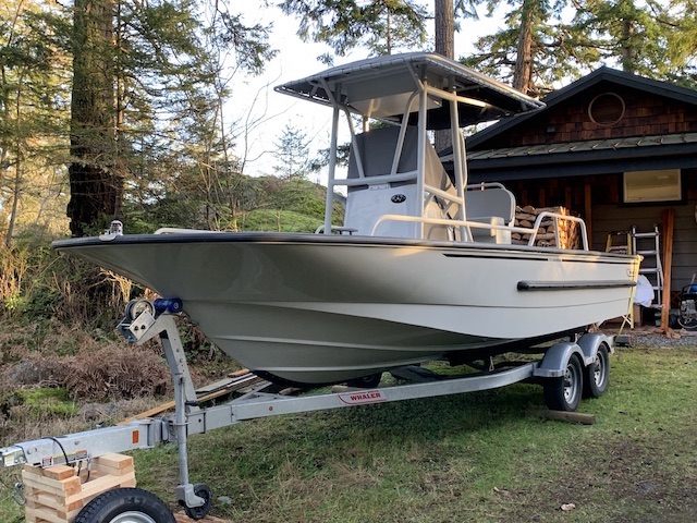

The Guardian T-Top was $7105 US direct from factory, which is about 75% retail if you could order one. Yes, very expensive, especially when paying in Cdn $. But for me well worth the price. I'm getting older and becoming a fair weather wimp who is less inclined to want to bundle up and face the elements, but with the T-Top I'm more inclined to use and enjoy the boat year-round in all weather.
The Guardian T-Top is aluminum with an electrical box and much more skookum than the fibreglass top offered on the 210 Montauk, which retails for $8276 US. The Montauk top comes with 4 rod holders, whereas I purchased mine for $100 Cdn each.
Peter O.
Addendum: The same T-Top was offered as an option on the 19' Guardian for the same price. The tops are rated to carry 150 lbs of gear, and military and enforcement builds often load them up. The T-Tops are offered as a factory install only, so presumably include some extra reinforcement in the hull.

Re: GUARDIAN 18 Adding T-Top
Postby jimh » Tue Jul 07, 2020 6:50 pm
The Boston Whaler OEM T-Top is properly engineered and designed, and the hull it will attach to also carefully designed to bear the loads. An aftermarket T-Top will not be anything like a Boston Whaler T-Top, and the hull won’t have been redesigned for a T-Top.
The engineers at Boston Whaler use sophisticated descn tools to match the strength of the T-Top frame structure at the point of attachment to the hull to the rigidity of the hull, and in that way the T-Top is not stiffer than the hulk or vice versa. Unless the two structures have the same flexibility, the movement of one will tend to cause cracks in the other. Buying some random aftermarket T-Top and bolting it down to some random places in the hull of a Boston Whaler boat usually results in the welds in the T-Top breaking or the hull cracking, depending on which part had greater stiffness.

That [Brunswick Commercial and Government Products 210 GUARDIAN OEM factory designed and factory installed T-Top shown in several illustrations above] is nearly identical to the one I had on my Hydra-Sports sans the powder coating and lack of rod holders. I liked the way they had dual rails above—one for the top to be tied to and one as a grab rail. Most of the cheaper tops use one rail and the fabric is not wrapped around it so you have to grab between the strings that hold it on.
