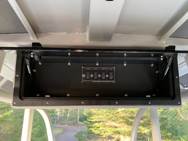

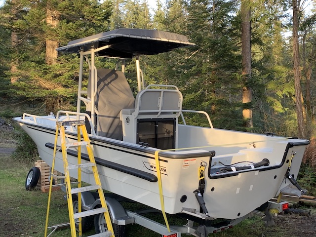

The Guardian T-Top was $7105 US direct from factory, which is about 75% retail if you could order one. Yes, very expensive, especially when paying in Cdn $. But for me well worth the price. I'm getting older and becoming a fair weather wimp who is less inclined to want to bundle up and face the elements, but with the T-Top I'm more inclined to use and enjoy the boat year-round in all weather.
The Guardian T-Top is aluminum with an electrical box and much more skookum than the fibreglass top offered on the 210 Montauk, which retails for $8276 US. The Montauk top comes with 4 rod holders, whereas I purchased mine for $100 Cdn each.
Peter O.
Addendum: The same T-Top was offered as an option on the 19' Guardian for the same price. The tops are rated to carry 150 lbs of gear, and military and enforcement builds often load them up. The T-Tops are offered as a factory install only, so presumably include some extra reinforcement in the hull.
