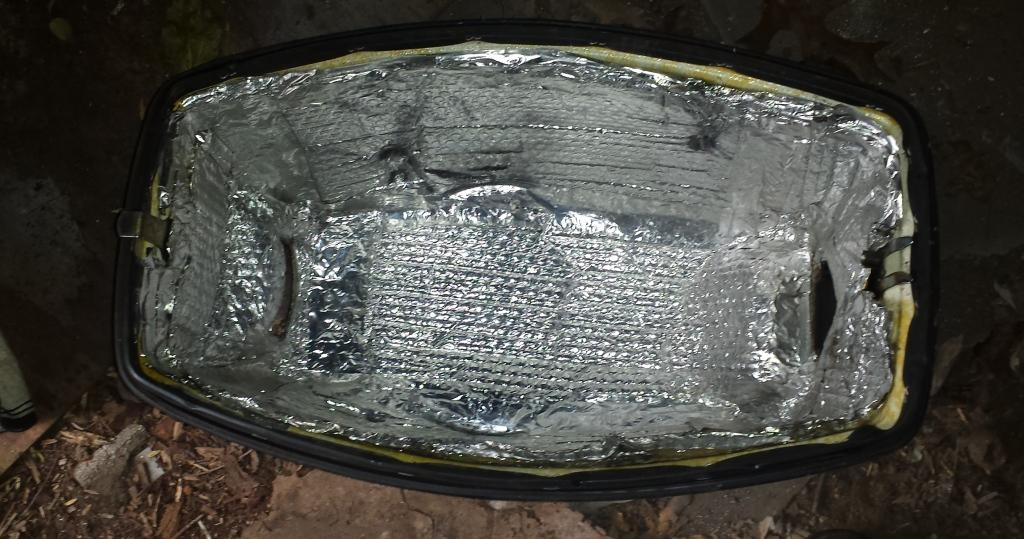

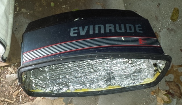

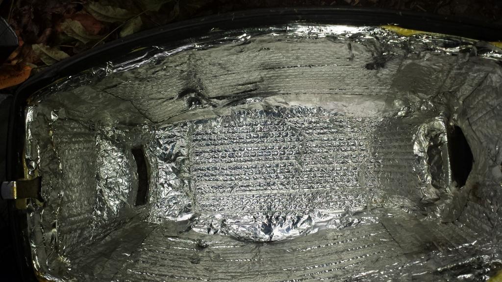

Here are a couple of pictures of the stuff I glued (self adhesive) inside my 1986 Evinrude 25HP commercial I use on our Achilles.
Not much room left as you can see by the edges curling up and the indentation of the flywheel cover.
Bottom line it did help [reduce the noise from the engine], together with the old foam (that started to deteriorate).
