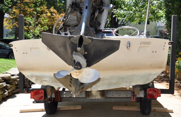

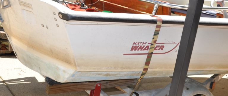

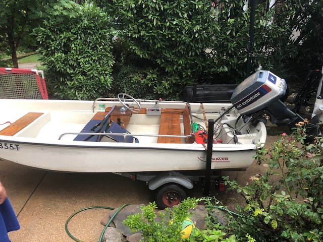

I recently purchased this 1978 SPORT 13 SOURPUSS to restore as close to original with my 3 kids. Our goal is to complete it in the off season so it can be used next summer.
This is our first time owning a BW and first time trying to fix one up so we appreciate any and all advice.
Spent a lot of time looking at various 13 footers, in a range of conditions. We decided on this one because it was in good shape, seemed to be all-original (or pretty close), was used in fresh water in Vermont and had been owned by one family since original purchased. The seller was a great help in the process. We live in Maryland, so we trailered it down here and it was uneventful (which is good) and now its in our driveway and garage. Once finished we will take it up to Mount Desert Island Maine and have it up there for the summers. We are normally in Maine for 3 to 4 weeks, where it would be in the water sitting for most of that time.
Plan is roughly to document location of all parts now, then dismantle and remove all items from the hull. Patch and repair hull, sand and varnish the wood. Replace some wiring, add a new gas tank, battery, and reassemble. We will tune the engine as needed but it runs well so we won’t do much to that unless needed> I would like to clean up the outboard and cover, as well as shifter mechanish but want to keep original. Almost all of the chrome will be reinstalled and remain the same.
First Step of this process is the hull. I’m mapping out where everything is, and taking a photos to start taking it apart. We planned to then flip it over and work on the bottom first. I have read a lot on the forums about bottom paint and refinishing and the more I read the more uncertain I am about exactly how to go about this. My original plan was to remove the bottom paint and go back to original gel coat, desert tan interior and white on outside. I know the boat will sit in water for 3-4 weeks a year, but planned to clean each season and thought it would be ok.
In terms of bottom paint removal, the paint is already very thin on bottom so planned to sand it off with an orbital sander, fill cracks and dings and then would gel coat it. Sanding and filling we thought we could do ourselves, but debating about trying to tackle gel coat ourselves. In particular on the interior and non-skid surface we were thinking we might find a yard to put on fresh gel coat. I’ve seen a range of comments on the site about how hard it is to remove the bottom paint and how messy that is along with the prep. Despite all of those warnings we are still determined to give it a shot, but debating whether it is worth it. Also considering if a boat yard can end up with a better finished product than us first timers, so maybe it makes sense for us to do some of the prep and sanding work and then get a yard to spray it.
Given the photos attached, I’d like to get fresh thoughts to make a final decision on the path to go on the hull.
1) Eliminating bottom paint and returning to Gel Coat
2) Whether we DIY this, find a pro to do it, or some hybrid of the two
Assuming we did decide to outsource this, any recommendations in Maryland (in and around Annapolis or eastern shore is ok) for this work.
Thanks,

Postby biggiefl » Thu Sep 10, 2020 12:29 pm
Your boat is not a Sourpuss model as they had a different console and center steering.
As far as your concerns about the bottom paint. I would try and remove a section using paint stripper or even a razor blade to see how good it was installed to begin with. If it was done properly it will not be an easy job. Keeping a boat in the water for a month, it should have bottom paint as gelcoat can absorb water and blister. Petit makes a vivid white bottom paint that would be much less noticeable than a color. Do NOT get shark white as it is actually grey.That boat looks clean and I highly doubt it needs new gelcoat which would be VERY expensive. To clean the scum line use MaryKate's On/Off hull cleaner or bar keeper's friend/comet. I would highly suggest a light wet sanding, a good compound, then polish & wax. Painting or gelcoating a hull can seriously affect resale. They are only original once. I would leave the controls alone as well.
PS...your stern lifting eyes are on upside down.

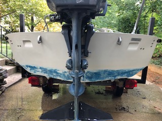

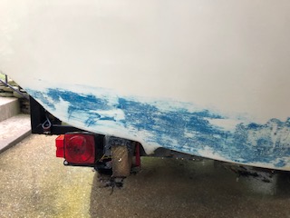

Postby Dive96 » Sun Sep 13, 2020 5:54 pm
Thanks for the advice here to focus on the cleaning of the hull. I did a test run on the transom today. Used Bar keepers friend and a quick scrub and was a major improvement. I was a little hesitant to use the MaryKate in my driveway because of how strong/caustic it is (as I read more about it). Used the BKF soft scrub on the left side of photo, and spray bottle version on the right of photo. It took off almost all of the scum. and actually brightened up the bottom paint (by uncovering it), but it also took off a fair amount of the bottom paint. I think I will go at it and the paint again with a scrubber pad on drill or scrub pad on my sander. I''m guessing most of the paint will come off, and looks like gel coat underneath so i may be able to get back to that. Thanks.

Postby jimh » Sun Sep 13, 2020 7:15 pm
You can and probably should dilute that Mary-Kate stuff with water. Or flood your driveway with water so any of the goop that drops off the boat will be diluted.
