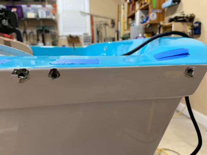

First failure: I started to install the rub rail. I drilled the first 13/64-inch-diameter hole (seen at far right below), and I used 3/16 x 5/8-inch rivets. The boat hull is pristine and all original holes have been filled in.
I got to the second hole and [the rivet] wouldn't bite.
I tried a third hole using a 3/16-inch-diameter drill bit, and [the rivet also] pulled out.
I aborted the project until I do some more research. At this point, the first rivet came out too.

Marlinmate--I'm no expert, but in Spring of 2020 I replaced the three piece [rub] rail on my 15-footer. I followed the tutorials linked above. Having an extra set of hands, or multiple grip clamps to hold the rub rail receiver (rigid plastic channel) in place while beginning to rivet it in place is essential to prevent undue stress on the rivets when starting out. Also, as a side note, the black rubber insert (final piece of rail) is best installed with an extra set of hands to prevent scuffs.
As for your choice of rivet size, it sounds like the rivet shank may have been too short to fully penetrate the two sections of the hull, and allow it to grip on the backside of the fiberglass. The rivets that came with the rail kit I purchased from Specialty Marine were 3/16-inch [diamter] with a length of 2-3/8-inch (also called Grip range of 0.751 to 0.875-inch) with a large head to help spread the clamping force on the U-channel. As you mentioned above, it sounds like you used a 3/16 x 5/8-inch rivets.
For comparison, Specialty Marine lists the same kit/rivet size for your 13' as my 15'.
REF: https://www.specialtymarine.com/collections/classic-13-1958-1976/products/boston-whaler-oem-rub-rail-fits-classic-9-17-off-white-with-black-insert
From your photo, it looks like possibly your rivets weren't long enough, and were trying to expand and clamp while still inside the fiberglass [laminate layer].
I'd suggest comparing your existing rivets to something on par with the outlined and specified ones above.

The hole position in your photo is too high. Should be in the middle of the rigid insert. Down say 1/2-inch.

Regarding the cracking of the gel coat layer: the gel coat layer of the laminate is very brittle, and trying to expand the rivet against the gel coat layer is always going to result in the gel coat layer fracturing and cracking apart. The rivet length should be sufficiently long so that the expansion end of the rivet is expanding against the foam inside the Unibond hull, with the rivet being drawn down to bear against the laminate layer.
I am not a big fan of rivets. You really need to get the right rivet for a rivet-fastened attachment to be good. But if you get the right rivet and get that rivet installed just right, the river should hold firmly and for a long time.
Good luck with the re-fit with the longer rivets.

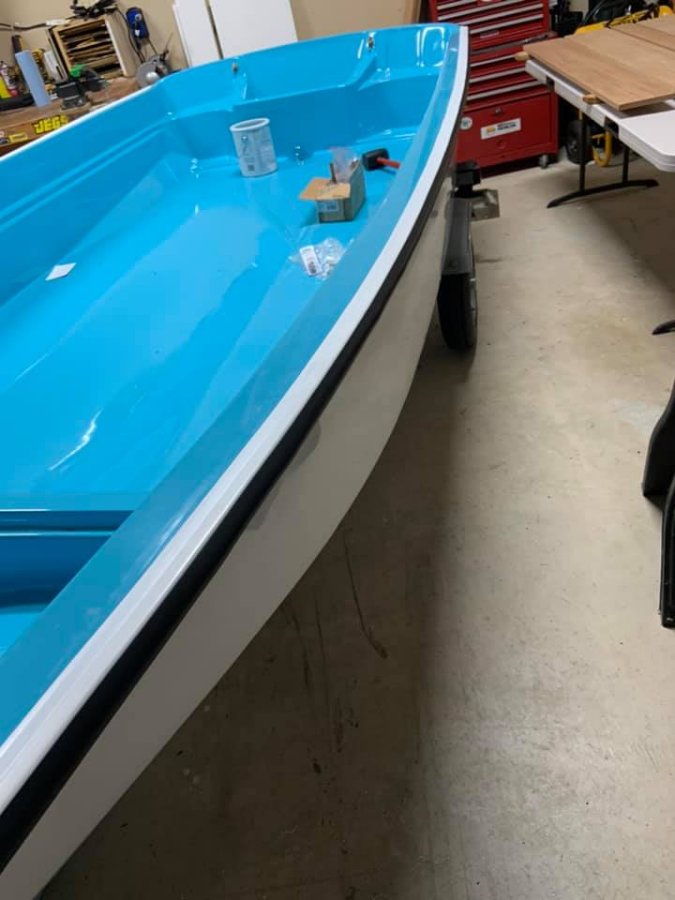

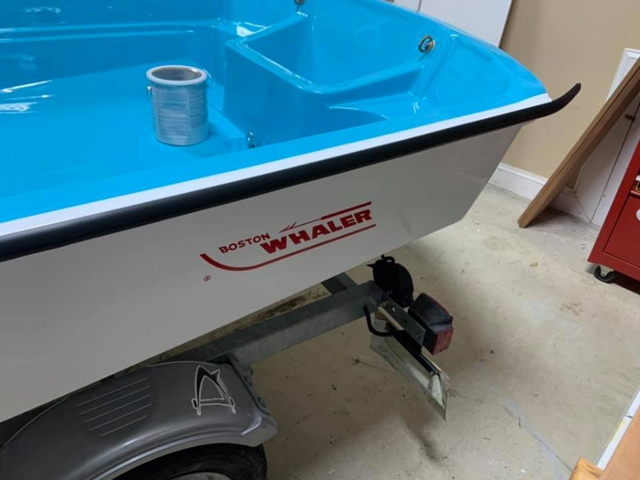

RUB RAIL UPDATE - I ended up getting some screws from Sue L at Beacon. Self tapping, Stainless, and with some sort of orange epoxy already on them.
I used at least 4 clamps and started on the port side. My 15 year old son learned some new words, but in the end, we got it installed.
Started out predrilling each hole with a very small bit. Injected some 5200 into the holes and then screwed in the screws. That lasted about 10 screws and then it was just straight self tapping them into the rubrail and boat.
Son had a heat gun and was working a few feet ahead of me all the way around the boat.
One small area on the bow where the L Channel (of the 3 piece rubrail) raised up. Hoping it will lay down once out of the garage and in the sun. Its only about 2 inches
