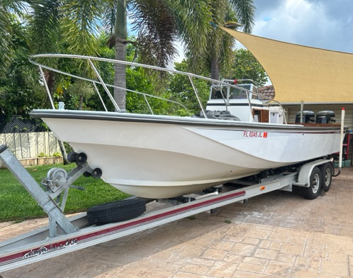

Introducing "Mutation"--formerly a 1998 TEMPTATION 2500, and now converted to an OUTRAGE 25 Whaler Drive
We are happy with what we have and the relatively small investment. The hull is in superb shape and has never had bottom paint.

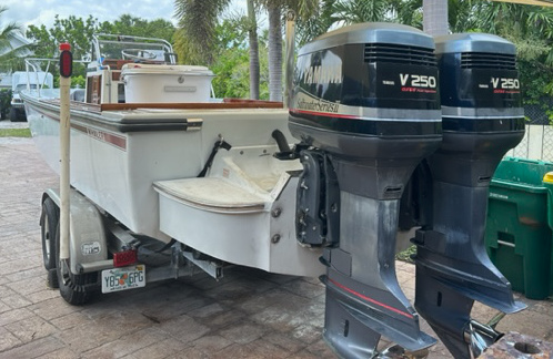

Fig. 1. A 25-foot hull.
Twin Yamaha OX66 250s are fitted and rigged with Saltwater Series II propellers in 21 pitch.
Fig. 2. Twin engines.

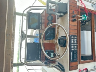

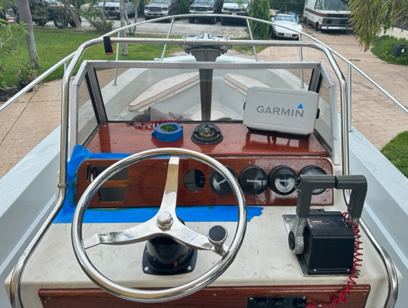

A few electrical things to sort and we should splash this week.
Fig. 3. Helm console

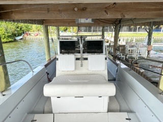

To keep it on subject, here is the console and interior with fresh Anderson Upholstery and new Electronics
Fig. 5. Upholstered seat forward of center console.
console front.JPG (45 KiB) Viewed 9424 times
Fig. 6. New electronics at helm.
console lectric.JPG (47.16 KiB) Viewed 9424 times
