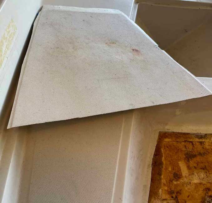

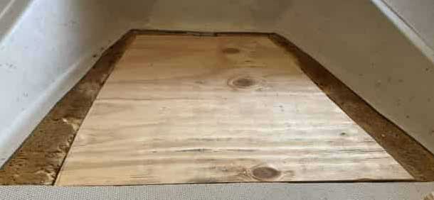

Fig. 1. Portion of foredeck cut out and removed.
Fig. 2. Removed section of deck.

Q9: in Figure 1, is the squarish section the void in the foam?
I cannot distinguish where the wood is, or where it's supposed to be.
Bonding new wood to the underside of the removed fiberglass section should be fairly easy. Just weight down the properly sized and resin coated replacement plywood. No need to go exotic, like vacuum bagging the part--it's just a flat piece. Make sure that the new wood is really flat and has no natural curve or bow.
Using non- epoxy resin for attaching would be a bit of cost savings. I'd recommend using epoxy for the cut repair on the topsides, minimal shrinkage over time.

The rotted wood [that was the reinforcement for the trapezoidal section section cut out of the deck] was not bonded to the foam.
It's difficult to see, but the foam will meet the underside of the gel coat skin around the sides and front portion. About 1 to 2-inch inches in from the sides and front, the foam level drops 1/2-inch to accommodate the plywood I removed before taking the picture.
The squarish section in the center [seen in Figure 1] appears to be from a prior repair; this is where there are potholes in the foam. They're not too large, perhaps 1/2-inch deep in areas.

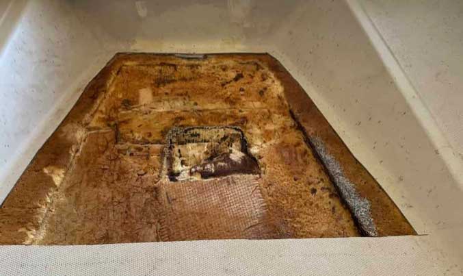

Fig. 3. A new piece of plywood is fitted into the cut-out section. Notice how the top of the wood is flush with the surrounding foam.
Don--note the slight bow in the plywood on the right side. Your comment about ensuring the new wood is flat is relevant. I’ll need to make some more sawdust.
