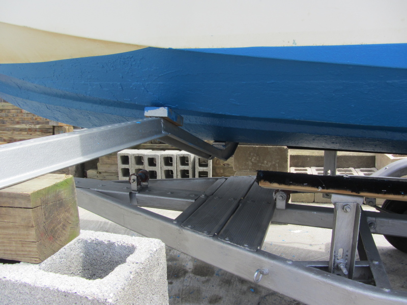

Back to the original question: I have lifted my 160 Dauntless off of the trailer in my driveway. I used the tow eyes on the rear to secure the boat to a tree and pulled the trailer about 24 inches forward to expose the rear end of the boat. I then used a floor jack to lift at the keel with a block of wood in between about 1-2" off the trailer. Jack stands (think Harbor Freight or Northern Tools) are placed under the stern to support the rear end of the boat. The jack can then be used to lift the bow end of the keel and a third stand placed under it. Take care that the location of the bow support may need to be changed as you pull the trailer out and in. Two jack stands up front will accomplish this. Another thing to note: raise the motor all the way up. In the unlikely event that you drop the boat, repairing the fiberglass will be the least of your worries compared to replacing the lower unit on your outboard. I've seen that scenario play out before, not by personal experience.
