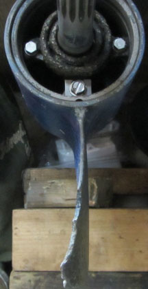

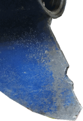

The illustrations below show the bend and a missing chunk. I can repair the missing chunk. The bend is my problem.
Fig. 1. A bent skeg.
Fig. 2. A missing chunk.
Re: Heating Skeg with a Torch to Bend
Postby Phil T » Tue Dec 28, 2021 5:13 pm
Going out on a limb:
--given the bend is on the bottom half, I would say try using compression or a hammer with a little heat;
--worst case, cut off the skeg and install a skeg guard.
Postby jimh » Wed Dec 29, 2021 6:55 am
Put the skeg between two pieces of wood. Put the wood and skeg in a large bench vice--hey, every good workshop should have a large bench vice. Slowly tighten the vice.
Postby Oldslowandugly » Wed Dec 29, 2021 10:40 am
The bend is a strange bend as usually the whole skeg is bent to one side or the other, which really doesn't affect the flow of water past the skeg. But this bend is like it was caused by going in reverse at a high rate and hitting something solid. This bend would act similar to the adjustable fin on the cavitation plate. That would explain the missing chunks too.
I do have a large vise on my workbench. My plan was to use the press and clamp the skeg between two press plates and apply force that way.

Postby Oldslowandugly » Wed Dec 29, 2021 4:24 pm
The skeg bent easily with the 12-ton press.
Fig. 3. The bent skeg after straightening.
I was right about the rebound. It did not stay straight when pressed flush with a press plate. I had to take a piece of 1/4-inch bar stock and position that past the bend point. Then I pressed it again going slightly past flush. It rebounded back to perfectly straight.
I then massaged it as flat as I could with a small machinist hammer. Much easier than steel.

Postby Oldslowandugly » Thu Dec 30, 2021 2:26 pm
What is the best method to fix the missing chunk in the skeg?
I normally use Marine Tex to fill small holes and crevices. There is no heating involved, and Marine Tex is a very strong repair.
I can have a welding shop use TIG to fill the damaged area.
There is a process called aluminum brazing that used melted aluminum, a torch, and filling with TIG rods.
Once I have the gearcase empty, heat is no longer a concern.
Postby jimh » Fri Dec 31, 2021 8:15 am
Oldslowandugly wrote:What is the best method to fix the missing chunk in the skeg?
Obtain some aluminum sheet of the same thickness as the missing portion of the skeg. Cut and shape the aluminum sheet material to the shape of the missing portion of the skeg. Weld the replacement material into the skeg using the appropriate welding technique. File and fair the weldment to create a smooth transition.
