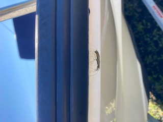

Phil, what’s your suggestion on repairing this? See attached photo. Damage is about 1-1.5 inches wide under bow rub rail.

Postby Phil T » Sun Feb 13, 2022 9:08 am
With a small nail I would pick at the cracked gelcoat to remove any loose pieces.
Apply painters tape to underside of the rubrai and 1" from the edge of the damaged area.
Sand the exposed fiberglass to rough it up.
Wipe off residue with Acetone.
Apply Marine Tex using plastic putty knife so it is just level or slightly higher. Cover with clear packing tape to get a smooth finish. If there is too much material, remove,replace and reapply tape. Remove after 2 hrs.

Postby Jefecinco » Sun Feb 13, 2022 10:08 am
It appears that the cracks may extend up under the rubrail. I hope your repair can be made without removing it.

Oh the rub rail! That was my next question. How do I remove it if I need to? Any tricks?

Postby Phil T » Sat Feb 19, 2022 8:18 pm
Off the top of my head.
The rub rail is made from two parts. Receiver and insert (middle piece).
Remove the insert, starting at the stern end and work your way toward the bow past the damaged area.
The receiver is attached with rivets. I would drill through the rivets for 2' on each side of the damage and try to press the down a bit to access. If more room is needed, drill more of the rivets out.
Once repaired, seal the old rivet holes with marine sealant. Position the receiver back in place and drill pilot holes through receiver and gunwale cap next to each rivet hole and then insert sealant and drive #6 x 1-1/2" stainless screws.
Reinstall the insert.
