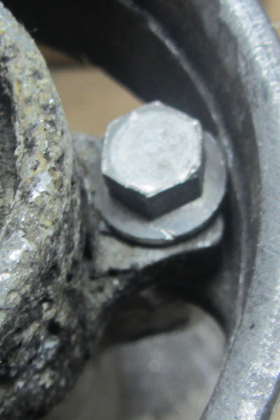

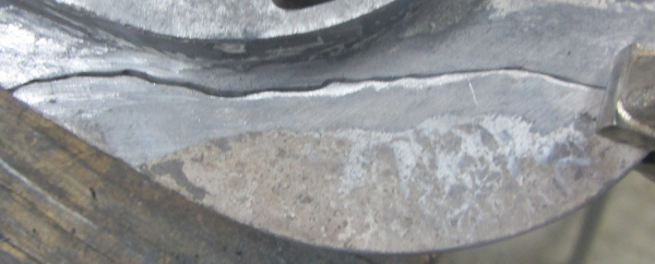

The empty parts gearcase was de-greased and all threads chased with a hand tap.
The cracked anti-ventilation plate was repaired by a welding shop.
Because the upper driveshaft bearing carrier had to be replaced with a new one taking a measurement from the pinion gear to the carrier mounting flange was required. There is an expensive tool kit to do that. I was able to locate the exact measuring tool part for a 40-48-50 hp motor on the internet at a cheap price.

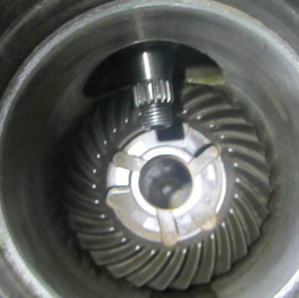

The pinion gear must be installed onto the driveshaft and the nut tightened to a torque of 45-foot-lbs. The thrust bearing is installed next, with two thrust washers, and the upper bearing carrier onto the driveshaft. Tape the splines so they don't cut your new seals.
I also found the OMC collar that the carrier sits on for measuring on the OMC tool. You could get by with just letting the carrier sit on a vice with the driveshaft hanging between the jaws. I used the vice to hold the OMC collar. Measure from the flat edge of the pinion gear to the flange of the carrier. The measuring tool is exactly 7.002-inches long. You could use a length of bar stock exactly 7.002" long for a measuring tool. The clearance gap must be 0.030-inches. Any more than that requires thrust washer shims to bring it to specs. The original shims were destroyed when taking the unit apart. They measured at 0.006 and 0.007-inches together making the required shim pack 0.013-inches. When I installed the measuring tool the gap was exactly .030-inches, and no shims were required.
On the other fresh water gearcase no parts were replaced so I was able to use all the original bearings, washers, and shims. When building from scratch with non-original parts it is imperative to measure everything.

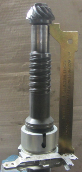

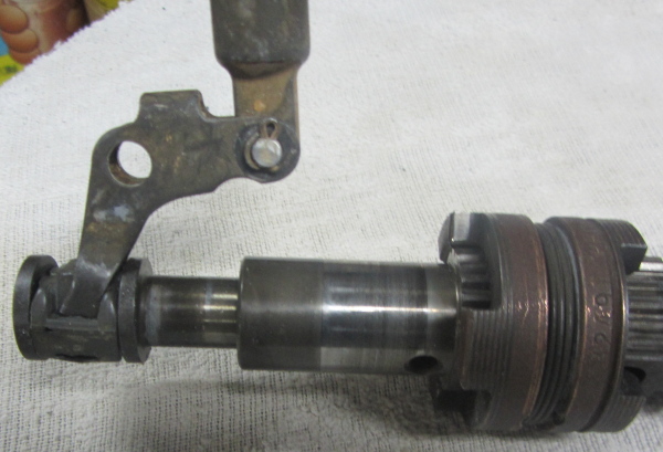

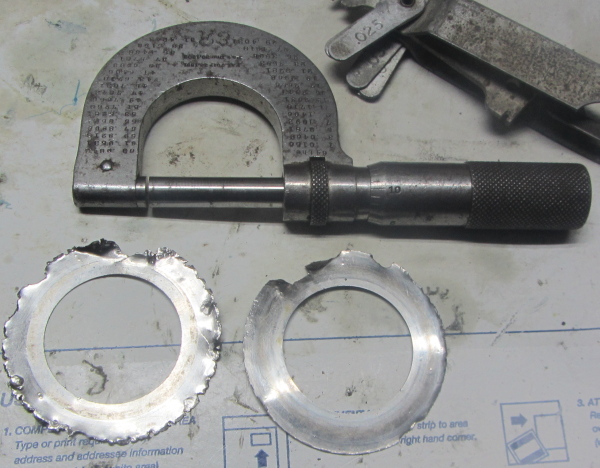

The assembled parts are measured with 7.002-inches-long gauge. The gap must be 0.030-inches. The OEM shims totaled 0.013-inches. The new parts measured exactly 0.030-inches and required no shims.
- O.013-inch OEM shims ruined during extraction.
- IMG_0350.JPG (147.49 KiB) Viewed 13213 times
- Driveshaft parts assembled and measuring tool used to check for .030" gap.
- IMG_0349.JPG (82.4 KiB) Viewed 13213 times

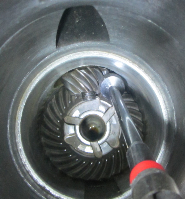

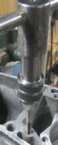

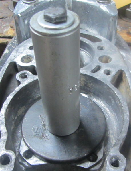

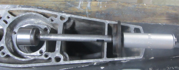

The new bearings are placed into the gearcase. I have the correct OMC tools for this, but there is a workaround. First I assembled the pinion bearing tool and placed the pinion bearing onto the driver end. Use some OMC needle bearing grease to hold it in place.
I dripped some gearcase lube into the cavity to ease the installation. The tool is used to drive the bearing down into the cavity and places it at the correct height.

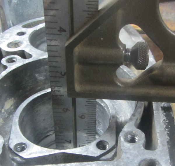

If you had prior measured the top of the old pinion bearing to the top of the gearcase you could use a length of the proper sized pipe to drive the new bearing in to the same height. After driving the new bearing with the correct tool I then measured the installed height. It was 6 and 5/8-inches. Now you can install the bearing at the correct height without having the measuring tool.
Take the pinion bearing retaining screw and screw it into the side of the gearcase. Use LokTite on the threads, a new O-ring on the shaft, and a bit of sealer on the threads near the O-ring. Torque to 40 to 80-inch-lbs.
If you accidentally drive the bearing in too far, you can drive it down and out all the way. The factory service manual says to use a new one if the bearing is removed for any reason. That recommendation is due to driving out an old bearing usually ends up damaging the bearing. The bearing I removed from my corroded gearcase was as good as the new one maybe because I oiled it up diligently. I saved it for a spare. A well-oiled new bearing should come out and be good for at least one do-over--if the bearing was not forced ino place. The rusty bearing I removed was badly damaged due to the force required to extract it.

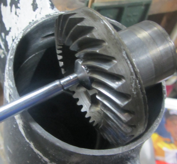

The last bearings to go in are the propeller shaft bearings at the very front of the gearcase. There are two bearings, one short, and one tall. Both are the same diameter. I have the OMC installer tool but you could easily use a length of the proper sized pipe to do this. The install tool gets assembled and the short bearing goes on first. The flat side with writing on the bearing faces up. Use OMC needle bearing grease to hold it in place. I squirted some gearcase lube inside to ease assembly. Place the gearcase on the floor open end facing up at you. Insert the short bearing on the tool or use a magnet-on-a-stick to get it down in place. The tool plate locates the driving handle so the bearing goes in straight. If using a pipe be sure it does go in straight. The handle gets hit carefully with a hammer. It will go in easily so if not don't just bang harder. See what is wrong. The bearing will bottom out and then the hammer will make a hollow sound indicating the bearing is at the stop. Then the tall bearing goes in. On the OMC tool the driver gets reversed and the tall bearing goes on the driver. Retain with the needle bearing grease. The flat side with writing faces up. It gets driven in the same way. It butts up against the short bearing and the hammer blows will sound hollow when it is at the stop. That is all of the gearcase bearings that get installed into the gearcase itself.

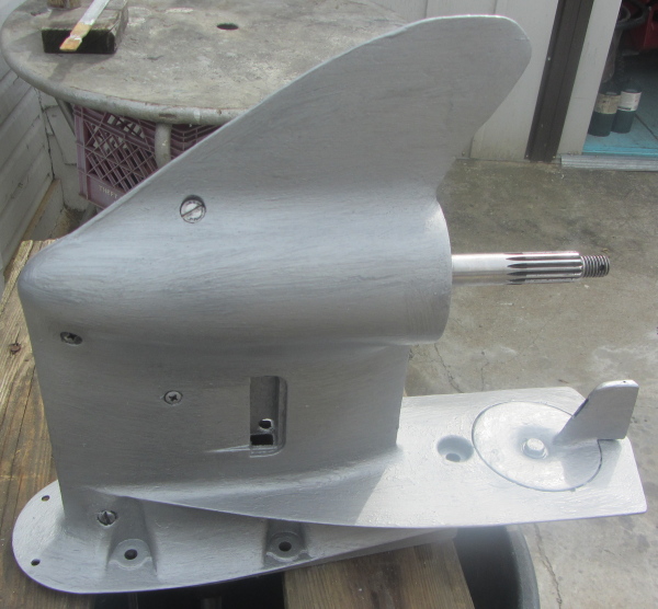

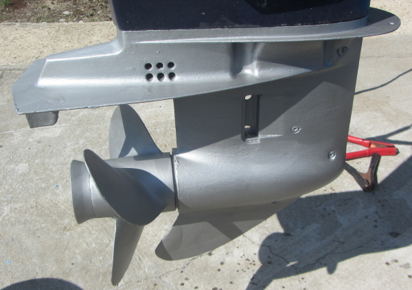

We had a few days of nice weather so I painted the finished gearcase. I fill the defects with Epoxy and fair it by hand. Then I use at least three coats of Interlux Primocon underwater metals primer. This primer is suitable for prolonged usage below the waterline. I find it extremely durable on aluminum parts.I am at the point in re-assembly of the parts gearcase that I must decide which type of seals to use on the propshaft bearing carrier. I failed at properly installing the single case extended lip seal that is now recommended for the propshaft. I found out that there is a special installation tool that is used on these type seals. It has an indented cavity that protects the extended lip. It goes for $100 and I am reluctant to spend that on a one-time-use tool. I am wondering if I can substitute something else but so far no luck. I may just use the two single lipped seals as I used on the other gearcase.
Re: Rebuilding Gear Case of 48SPL-Part 3
What would be the expected normal cost for the TIG welding you had done on the broken anti-ventilation, exclusive on any special friend-only pricing?
Oldslowandugly
- Posts: 719
- Location: Queens NY

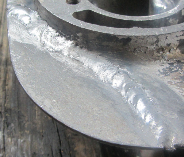

The repair was done for no charge; the welder owed me a big favor. I gifted him a 5-lbs sleeve of 4043 alloy TIG rods I had no use for.
This repair required much skill and experience. I watched through a welding helmet as he worked. The large mass of the aluminum gearcase was such a heat sink that he had to spend many seconds getting a molten puddle, then quickly jump the arc over to the broken part, then back to the case, to keep both sides molten. All the while feeding the 4043 rod into the puddle. It was fascinating to observe.
Tig welding is an artform, and with thicker metal like a gearcase (with a large mass), preheating is key for a good weld. That's why many places that weld outboard gear cases units ask for the gear case to be stripped. They preheat the entire gear case to prepare for welding.
I purchased a Tig AC/DC welder, used it three times, and recently sold it because I knew I didn't have the time to learn that process and most of my welding can be done with a spool gun attachment on a Mig.
If I do need something Tig welded, I visit a friend with the equipment.

We were working in a cold shop on a very cold day. The gearcase sucked heat like you wouldn't believe.dtmackey wrote:Tig is an artform and with thicker metal like a gearcase (large mass), preheating is key for a good weld...
My skillful buddy used to do welding at an aerospace company when he was young. He let his helper try and the helper made a weld as ugly as I would have. My buddy re-melted the ugly weld and just continued along. I love watching people work who know what they are doing.

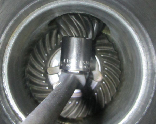

Next add the pinion nut. I used a short 11/16" socket and breaker bar to hold the nut. I packed the socket cavity with paper towel so the nut sat right at the top of the socket. Hold the breaker bar and turn the driveshaft to screw the nut on. A driveshaft socket is used or else a one-size-fits-all socket just fits the driveshaft splines. Torque to 40-45 foot pounds. Now you can install the upper driveshaft bearing carrier. I used Ultra Black on the gearcase flange surfaces. Anti-seize in the bolt holes. Tape the driveshaft splines so as not to cut the new seals. Lightly grease the driveshaft with Triple Guard grease. Slide the carrier down onto the case and bolt into place. Torque bolts to 14-16 foot pounds. Then we install the shifter rod and pivot. Slide the shifter cover assembly onto the shift rod. Keep it up and out of your way for now. Screw the shifter rod into the shifter pivot. Move the shifter dog into forward gear. The shifter cradle is put onto the end of the shifter dog shaft and is held in place with the OMC Needle bearing grease. Again, this is what you are doing. Use a flashlight and look at what you are doing. This time I realized there is a ledge cast into the shifter rod cavity just above where the propshaft enters. If you install the propshaft so the cradle just totally enters the cavity, then as the shifter rod/pivot is slid down in, the ledge guides the pivot arms right into the slots on the cradle. Kudos to the engineer that designed that casting. Once you are sure the pivot is engaged with the cradle then insert the pivot retainer screw through the side of the gearcase. I found a big nail with a sharp point ground on the end was perfect for sticking into the screw hole and maneuvering the pivot hole into position so the screw will go through it. Use a new O-ring and a bit of sealer on the screw shaft. Torque the screw to 48-80 inch pounds. Now slide the rod cover down the shaft. Triple Guard grease is used on a new outer and inner O-ring. The rod bushing threads are sealed with Adhesive M or 3M 847. Torque to 48-60 inch pounds. The cover bolts are torqued to 60-84 inch pounds. Here is the top end all assembled.

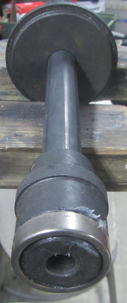

Timing is everything. I just purchased a used extended lip seal installation tool off the web. When it comes I will try again to install the new updated type seal into the propshaft bearing carrier. The tool is used not only for the propshaft seal but also the upper driveshaft bearing carrier extended lip seal. The new upper bearing carrier I purchased came with the new type seal installed. The parts kits now include the new type seals for both applications.

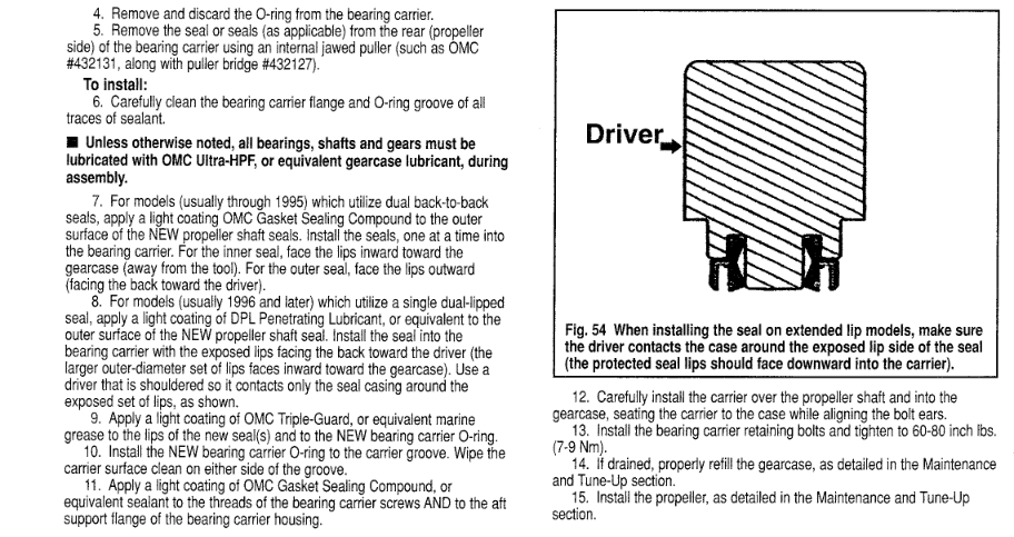

Here is what I found about the new type seals. This also says to use the DPL lubricant and not sealer on the seal. It may be that not having the proper tool is what ruined my attempt to install the new seal. But looking at the cross section picture, the pipe I used should not have damaged anything. I will still use my own sealer so there is no chance of leakage. I have one of the new seals left and I will install it when the tool arrives.

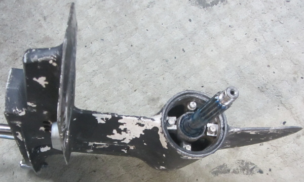

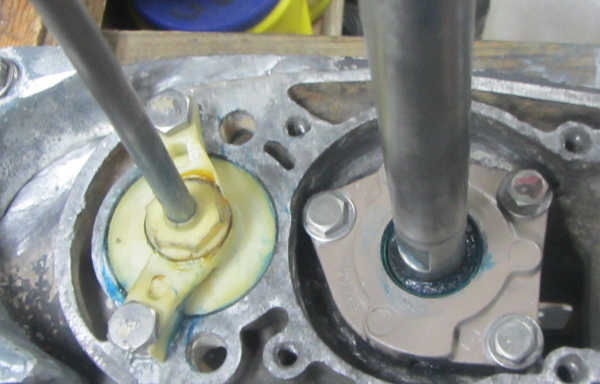

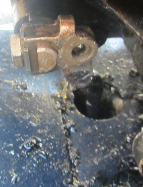

A nice day so I went outside to install the re-built 1996 lower unit onto the 1993 48SPL. After chasing all the threads I brushed some anti-seize into the bolt holes. I made sure the shifter dog in the gearcase was in neutral. The upper shifter detent on the powerhead must also be in neutral. Wipe some moly grease on the driveshaft splines but not on the top end. I fitted the lower unit onto the mid-section and screwed the big end bolt in to secure it. Then I screwed one of the four front bolts in so that the unit was tight against the mid-section. Here I encountered another problem. The top of the shifter rod did not fit correctly into the clevis that is part of the shifter detent on the powerhead. I had carefully measured the turns of the shifter rods on both lower units and they both were at 10 turns. For some reason the difference in manufacturing tolerances were such that the recorded shifter rod height was not correct. What I had to do was lower the rod by screwing it in one whole turn at a time because the top of the rod must point forward. Each time I made an adjustment I had to unbolt and remove the lower unit just to screw the rod in one turn then replace it and test again. It took a total of three turns for the hole in the shifter rod to meet the hole in the clevis perfectly. Then the clevis bolt can be inserted and tightened. Oddly the FSM shows no torque value for that bolt. The final height of the shifter rod is not really important. What is important is that the shifter dog in the gearcase MUST be in neutral. Verify by spinning the propeller. The shifter detent on the powerhead MUST be in neutral. At that point if the clevis bolt fits perfectly into the clevis and the shifter rod- you are good to go. Then you can install the rest of the bolts. Torque the four 3/8" bolts to 18-20 ft lbs and the rear 7/16"bolt to 28-30 ft lbs. My shift cables are not in place yet. If your cables were in place and the detent was not in neutral then you can adjust it. There are two bolts on the detent that loosen and allow it to be adjusted for neutral. Next comes a running motor test in a barrel of water.
- The clevis and shifter rod holes must align perfectly when everything is in neutral. Install bolt.
- IMG_0376.JPG (137.68 KiB) Viewed 12909 times
- Rebuilt lower unit installed on the 48SPL.
- IMG_0377.JPG (132.72 KiB) Viewed 12909 times

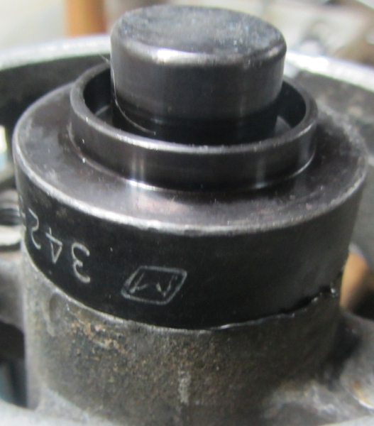

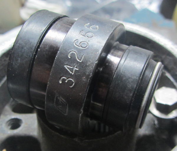

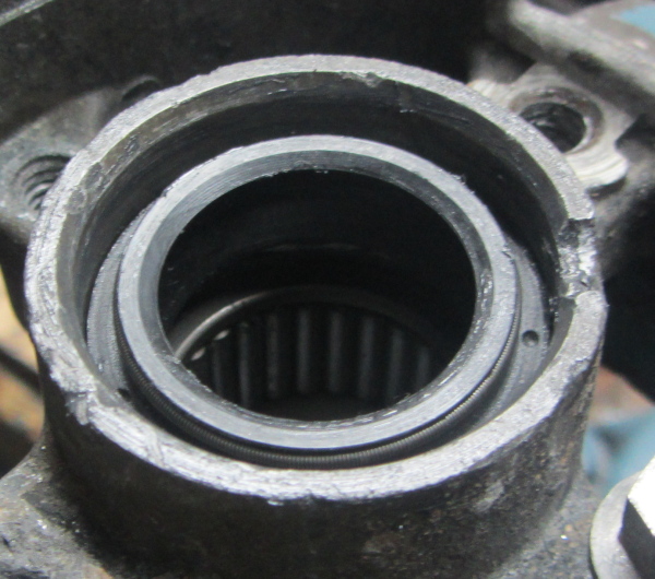

Here is the new type seal going in to the propshaft bearing carrier. I used a section of thin walled sink pipe last time. This time I have the proper tool so I will use it. The tool edge locates the seal and makes sure it is square in the bore. The difference is that I will use Ultra Black sealer instead of the DPL penetrating oil to be positive it doesn't leak around the edges like last time. Make sure the exposed lip faces towards you and the covered lip faces into the gearcase. The picture shows the correct position on the bigger seal [propshaft] and the incorrect position on the smaller seal [driveshaft]. The seal will fit the tool both ways so be sure it is correct. This tool works for both applications. Once in place fill the cavity between the seal lips with Triple Guard grease. Then I screwed two of the long bolts into the carrier for control. I wiped Ultra Black all over the O-ring and the carrier flange and inserted it into the gearcase. I again needed to use the big woodworking clamp and a section of PVC pipe to drive the carrier in the last inch. Once seated I installed the retainer clamps and bolts. After the sealer cures I will pressure and vacuum test.
- OMC 342666 seal tool. Large seal is correctly fitted. Small seal is not.
- IMG_0378.JPG (140.8 KiB) Viewed 12824 times
- Seal tool bottomed to carrier. Notice cavity to protect seal lips.
- IMG_0379.JPG (126.1 KiB) Viewed 12824 times
- New seal properly installed.
- IMG_0380.JPG (166.35 KiB) Viewed 12824 times
