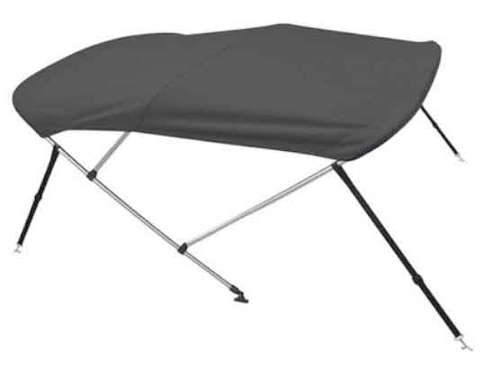

I bought a Westland Sunbrella Bimini top for $600 sunbrella and two rail-clamp hinges to try.
Fig. 1. A Westland three-bow Bimini Top with dimensions in inches of 46 H x 72 L x 61 to 66 W.

I am not clear on what part of the boat is what you describe as "the throttle hump." I think you are talking about a slightly raised section on the starboard gunwale where the remote shift and throttle controls are mounted, and this raised section is not mirrored on the port side. That raised area looks like a good mounting spot. If the support tube is too long, then remove the plastic fitting for the hinge, cut down the support tube by an inch or two, and reinstall the hinge on the tube. You could also use that approach to equalize the difference in the mounting height on the gunwale between port and starboard side. Also, consider replacing the plastic hinges with metal hinges. The metal hinge will be more durable in the long term.
If the Bimini top when folded does not fit well, a possible solution will be to replace the aft nylon strap with a fixed support tube, allowing the top to be folded and stored in an upright position. The drawback to that is the vertical clearance of the boat is fixed, and also you have to trailer the boat with the top stowed upright.
Fixing the hinges to the railing may be more useful. To support the top when folded down to the aft you could create some supports to hold up the frame so it does not bind or try to lay on the side rails. These could be as simple as a length of 2x4 lumber that is held to the rails with a Velcro strap and rests on the deck.
MICHIGAN130 wrote:Q3: should the top fold down to forward or aft?
I think folding the top to the stern is probably the most useful. If the top is folded toward the bow then it will interfere with seating in the bow and getting to the bow.
If Boston Whaler offered a Bimini top as an option, their method of mounting the hinges would be good guidance.
I also bought and installed an aftermarket Bimini top on my SPORT 15. It was a close fit all-round. I described the process in an article at
https://continuouswave.com/maintenance-logs/bimini/
The top was mounted to the gunwales, but special hinges with a sloped base were needed; the top folded aft and just cleared the side rails.
