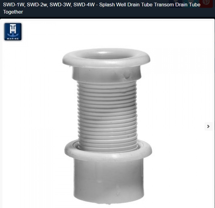

jimh--the tubes on that Outrage are different than the ones used in my Dauntless. See the attached picture from TH Marine:
TH Marine Splashwell Drain Tube part # SWD-4W
The two halves of that tube shown [above], press together. The larger diameter half is ribbed on the inside and the smaller diameter piece is ribbed on the outside. When the two pieces are pressed together, the ribs grab each other and the parts cannot easily be disassembled. The ribs are definitely not threads.

Here is TH Marine's description of the part used in my 2004 Dauntless 220
These splash well drains are molded of a high strength material that has some flex to allow for imperfect hole saw cuts and installation impacts. There are many import copies from other manufacturers, but our made in the U.S.A. splash well drain tubes will not break down from UV or chemicals. These drain tubes are far superior to other molded tubes on the market that are very susceptible to breakage. Unlike other molded tubes in the past that screwed together, these drains simply snap together and are impossible to pull apart.
This tube allows for a very simple installation with only a hole saw and a small amount of silicon sealer. The tube lip covers up raw hole saw cuts and fiberglass splinters. These parts are not only economical on a part cost basis, they also save a tremendous amount on installation time and the elimination of expensive flaring tools that are necessary for the metal drain tubes.
High strength, UV Stable polymer
Push together for secure fit
Semi flexible to prevent breakage
Available in 1" and 1-1/4" drain tube sizes
Available in black, white, and chrome plated
