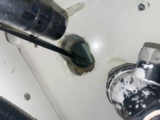

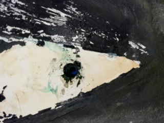

On my 2005 270 OUTRAGE with an AIRMAR SONAR through-hull transducer model B744vl I found a leak, occurring mostly through anti-rotation bolt hole. I removed the transducer, expecting to find that it was installed at the location of a putty box in the hull. Instead, I was disappointed at the very poor installation [apparently not using a putty box to surround the large hole through the laminates and foam].
Fig. 1. No caption has been provided to explain what is being illustrated.
Fig. 2. No caption has been provided to explain what is being illustrated.
Fig. 3. No caption has been provided to explain what is being illustrated.

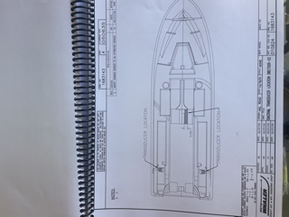

From reviewing the factory drawings there does not appear to be a factory supplied putty box for your model.
If you don't have the specific drawings for your boat model , you can download them for no charge at Whaler.com.
Select Year, family, model and doc type here:
https://www.bostonwhaler.com/resources-and-maintenance.html

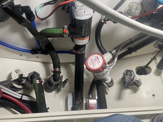

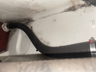

I found a drawing of approximate putty box locations
Fig. 4. No caption provided.
Fig. 5. No caption provided.
I do believe [the 2005 270 OUTRAGE boat will] have [a putty box], but the problem will be [the putty boxes] will not be in suitable locations for the RV220 SONAR transducers.

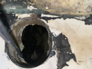

I think filling in the transducer hole and re-configuring the livewell pickup and forward fish box pump out would be ideal, and in that I could get the two transducers in ideal locations with plenty of headroom.
Fig. 6. No caption provided.
Re: 2005 270 OUTRAGE: SONAR Transducer Installation
Postby Phil T » Sun May 29, 2022 2:00 pm
Wow, a bit of a lot going on there [in Figure 6]. I see four through hulls. Yikes.
