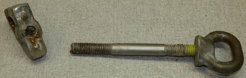

Postby alan-bc » Fri Jun 24, 2022 3:25 pm
dtmackey wrote:Just use the 3 points on the hull (bow and stern eyes)
Sadly, this is good advice only if the [lifting] tackle is in good repair. Mine obviously wasn't.
My Boston Whaler boat came smashing down onto the concrete of the carport from about 4 feet high. If I ever do get it inverted, I shudder to think what I might find.
