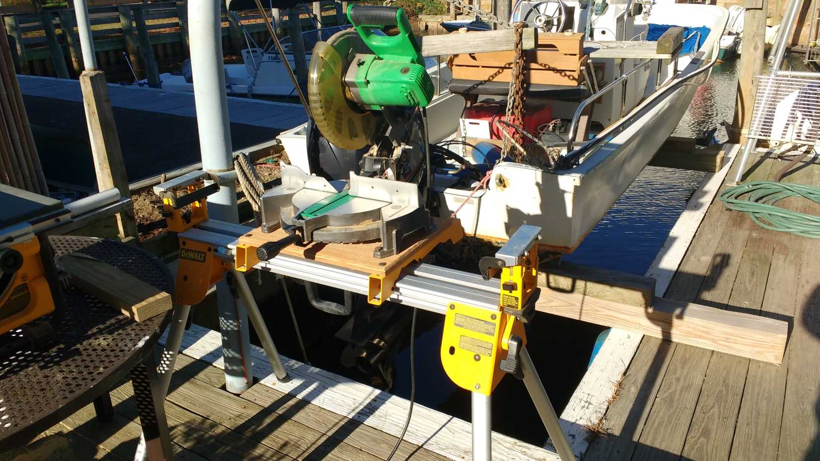

The Hitachi, although not a sliding miter (which would be very nice to have), was inexpensive and was simple to adapt to the DeWalt stand with a piece of scrap plywood cut to size and mounted to the quick disconnects that came with the stand. It still has the original blade and works great for cutting up to 2x6 lumber, although I have a nice 80 tooth Diablo blade waiting for my next round of trim work. It's kind of ironic that the stand cost a bunch more than the saw, but the stand makes the saw so much more user friendly.

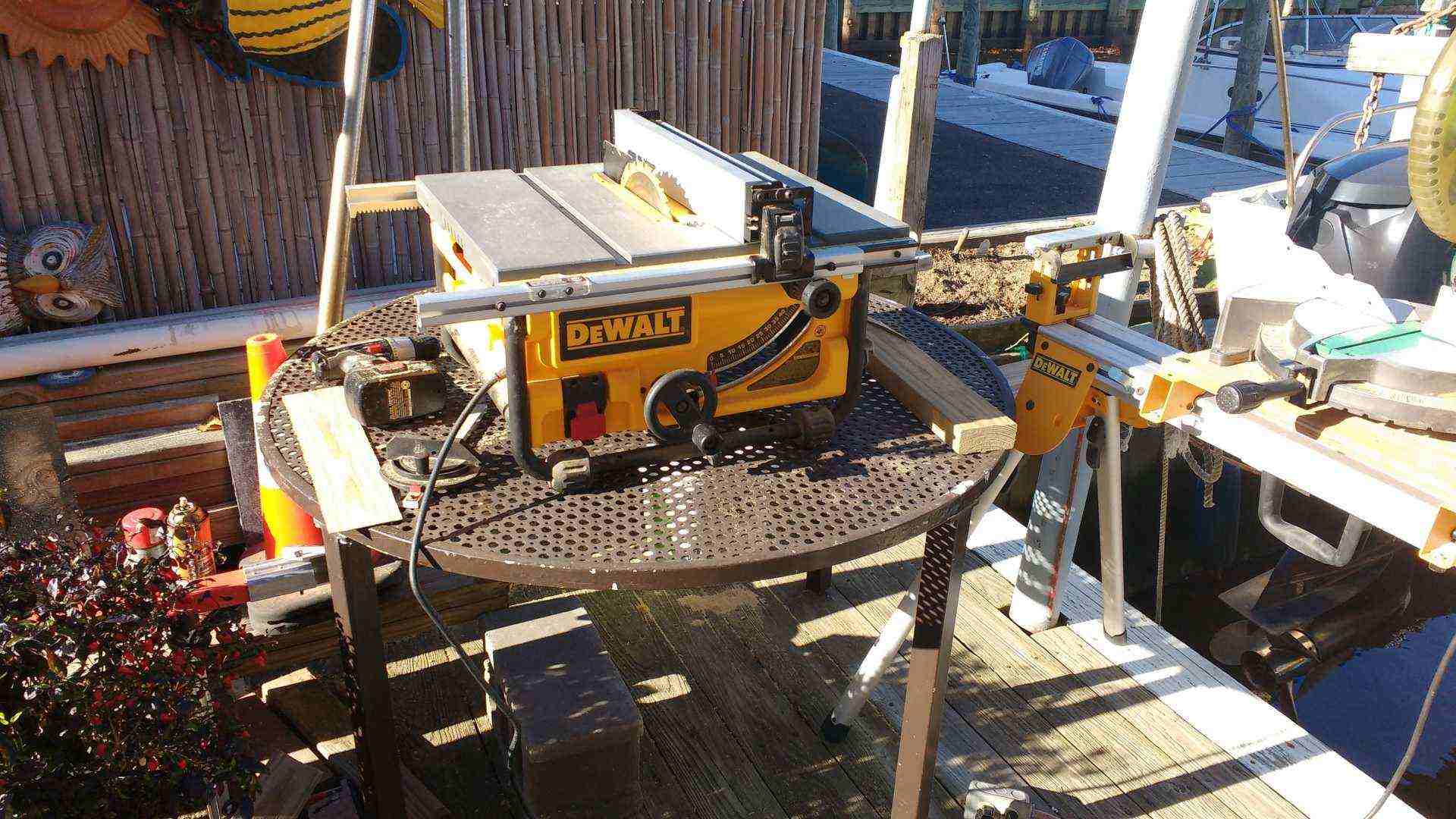

If I had to start over and could only purchase one saw I would start with the table saw. Then add a cordless kit that included a circular saw (and spare batteries). And keep adding on.
NOTE: I tried to add another post but it seems to have been lost. The DeWalt table saw comes with a great saw blade guard, I have it removed in the image I posted as I was ripping a tall piece of wood and could only go partially through on each pass (needed to flip it over to get the whole thing cut). You can't do that with the guard in place.

Sorry, I just saw qtr.'s picture of a saw. That would be perfect for what you describe.
Powerful and light weight.
