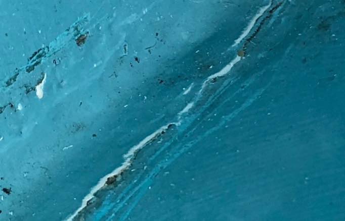

In June 2022 I started restoring a 1972 13-footer, I now have these questions:

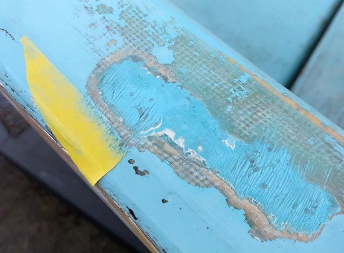

Q1: what should be done about a previous repair in which fiberglass was applied on top of the gel coat?
Q2: other than sand blasting, what is the best way to remove old paint from the deck non-skid surface?

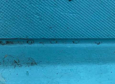

Q3: how was the deck held down with screws around its perimeter (which I infer was the method from the appearance)?
Q4: what was the deck made from?
I know some of the decks of older Boston Whaler boats are plywood. This deck is not flat.

Fig. 1. A prior repair, deemed substandard.
Fig. 2. More substandard prior repair work.
Fig. 3. Impressions of screw heads in the molded cockpit deck.

The impressions of screws in the deck are not screws. The are marks from the mold.
There are two skins of fiberglass bonded together and structural foam injected in between. There are no screws.

rctestflight wrote:Q1: what should be done about a previous repair in which fiberglass was applied on top of the gel coat?
If you are unsatisfied with a prior repair to a fiberglass boat, you can grind off the prior repair and try again.

rctestflight wrote:Q3: how was the deck held down with screws around its perimeter (which I infer was the method from the appearance)?
The appearance of screw heads is an artifact of the plug which was used to make the mold which was used to make the hull. There are no screws in the actual hull. The screws were in the plug.
Fiberglass boats are generally made in female contact molds. The molds are created from a plug. The plug is usually the prototype hull or a mock-up of a hull structure made just to create the mold that will make the production hull.
That Boston Whaler left exposed screw heads in the plug for the early 13-foot hulls is an example of the practical approach of the designer, Dick Fisher. Dick Fisher was also a bit whimsical, and he may have intentionally left those screw impressions in the finished hull just to confuse other boat builders about how the boat was made, just as he has apparently confused you.

Based on the impression taken from Figure 1 and Figure 2 above, the present condition of the boat has paint applied on old repairs which were applied on the gel coat layer.
With the original gel coat layer of the hull and deck now concealed by paint and substandard repairs, I doubt there is much opportunity to restore the boat to its original gel coat layer without very substantial work. If your purpose in acquiring this boat was to have a long and tedious restoration project, you have the purchased a suitable boat.
There is really no mandate that all old Boston Whaler boats must be restored to factory-new condition and appearance. A hull with repairs that protect the hull integrity and maintain the hull strength, covered by a nice coat of paint, are completely suitable for a boat whose purpose is to be operated as a small skiff and enjoyed for that use.
