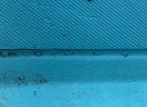

In June 2022 I started restoring a 1972 13-footer, I now have these questions:

I know some of the decks of older Boston Whaler boats are plywood. This deck is not flat.

Fig. 3. Impressions of screw heads in the molded cockpit deck.

The impressions of screws in the deck are not screws. The are marks from the mold.
There are two skins of fiberglass bonded together and structural foam injected in between. There are no screws.

rctestflight wrote:Q3: how was the deck held down with screws around its perimeter (which I infer was the method from the appearance)?
The appearance of screw heads is an artifact of the plug which was used to make the mold which was used to make the hull. There are no screws in the actual hull. The screws were in the plug.
Fiberglass boats are generally made in female contact molds. The molds are created from a plug. The plug is usually the prototype hull or a mock-up of a hull structure made just to create the mold that will make the production hull.
That Boston Whaler left exposed screw heads in the plug for the early 13-foot hulls is an example of the practical approach of the designer, Dick Fisher. Dick Fisher was also a bit whimsical, and he may have intentionally left those screw impressions in the finished hull just to confuse other boat builders about how the boat was made, just as he has apparently confused you.
