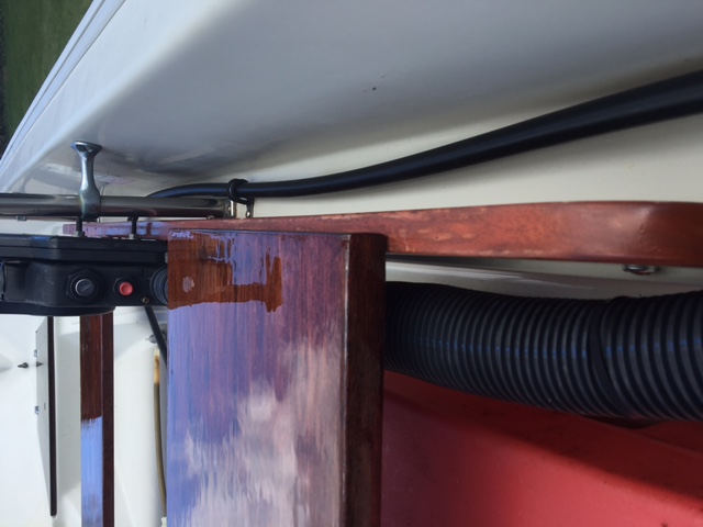

I just tried to raise my seat above the risers on my 1977 sport 15. The risers are bowed out and there is only a tiny overlap on the boards so it is not safe to sit on. I am wondering what to do.
I could put a wood strip screwed onto the side of the riser to extend it or add some L brackets.

even with overlap I still screwed a wood strip into the riser and then screwed the seats into those strips. Just seemed more secure to me.
