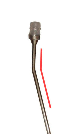

Figure 1 shows the OEM lamp with the [bend in the pole] highlighted
Fig. 1. A pole lamp with a bend whose angle to be determined by readers of this post.
Posts: 13336
Re: Navigation Pole Lamp Bend Angle
Postby jimh » Tue Jul 05, 2022 1:26 pm
I measured the angle of the bend in the image using an image manipulation program and found it to be about 14-degrees, or expressed as the red line is drawn in the illustration, 180 - 14 = 166-degrees
Why are you concerned with the bend angle in the pole?

I want the one I order to sit in correct orientation to the water. Perko makes lots of different options for angles.

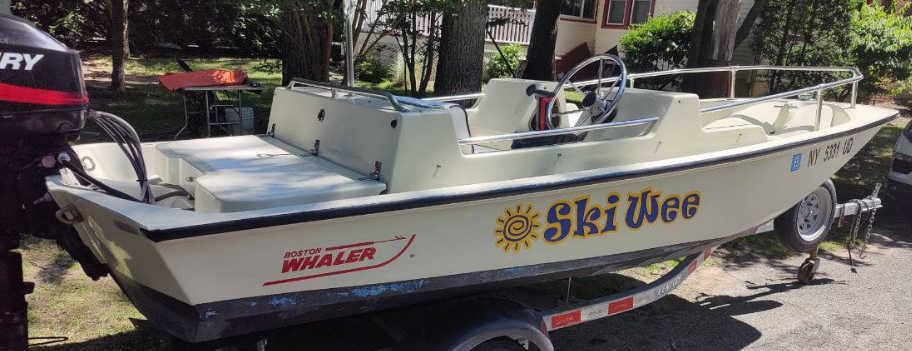

Fig. 2. The particular SUPER SPORT LIMITED 15 that is being discussed in this thread for replacement of a navigation lamp. If you look very carefully a ski pylon can be seen.
ski wee.jpg (47.64 KiB) Viewed 9220 times
I might add a vertical pole to the fiberglass seat back next to the ski pylon. Maybe even something that folds flat that can be out of the way. I am realizing now that where the ski pylon is mounted, having the lamp anchored to the transom might get in the way of the ski rope. This is probably why when I got [this used SUPER SPORT LIMITED 15 boat] there was no [white all-round pole lamp].
There is an electrical connection just below the ski pylon. I could get a lamp that attaches to the ski pylon.

The lamp pictured in Figure 1 has a Fresnel lens. That means it concentrates the light at the horizon. It will be important to get the lamp orientation vertical.
I infer you do not have the original pole lamp and plan to buy one. If you buy a pole lamp for a white all-round light, get one without the Fresnel lens. A lamp like that won't need to be oriented precisely horizontal. I also think a straight pole could be bent as needed with a tubing bender, as long as it was thin-wall steel [that is, to be perfectly explicit and clear, thin-wall stainless steel tubing that you might find used for very light railings or other purposes on a boat and NEVER common contractor supply store thin-wall electrical metallic tubing or EMT conduit].

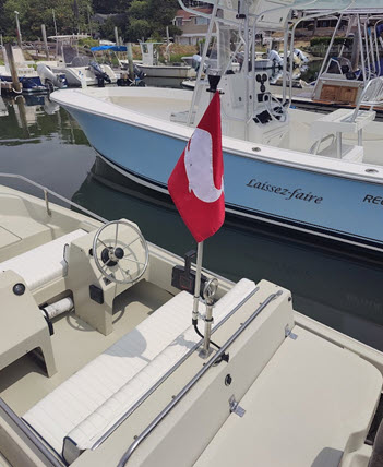

I decided to go with a modestly priced aftermarket articulating lamp on a 36 inch pole. I am going to attach it to the ski eye to make up some height - I came up with a way to do that that should not interfere with the ski eye performance. Will post an update when done.
I am going to attach a flag to it too. My daughters will be using this boat, and I figured having a fag on it will improve visibility. If the pole cannot stand up to the force of the flag, it should be simple enough to replace it with a heavier piece of 316 stainless tube.

Postby mikegcny » Mon Jul 18, 2022 11:30 am
This is what I came up with as to not interfere with the ski eye.
