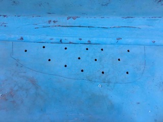

  • drilled 1/4-inch holes all over the areas in roughly a 2-inch grid

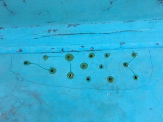

  • squeezed Gorilla Glue into each hole
  • wiped up any excess glue

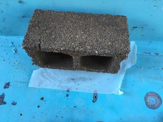

  • put bricks and other weight on top of the boards where there were boards and just put bricks and weights straight on the wax paper in other spots

Fig. 1. The area of the deck with drilled holes.
Fig. 2. The glue in the drilled holes.
Fig. 3. A weight atop the repaired area as glue dries.
