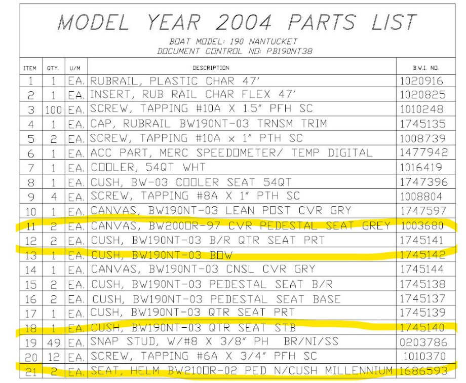

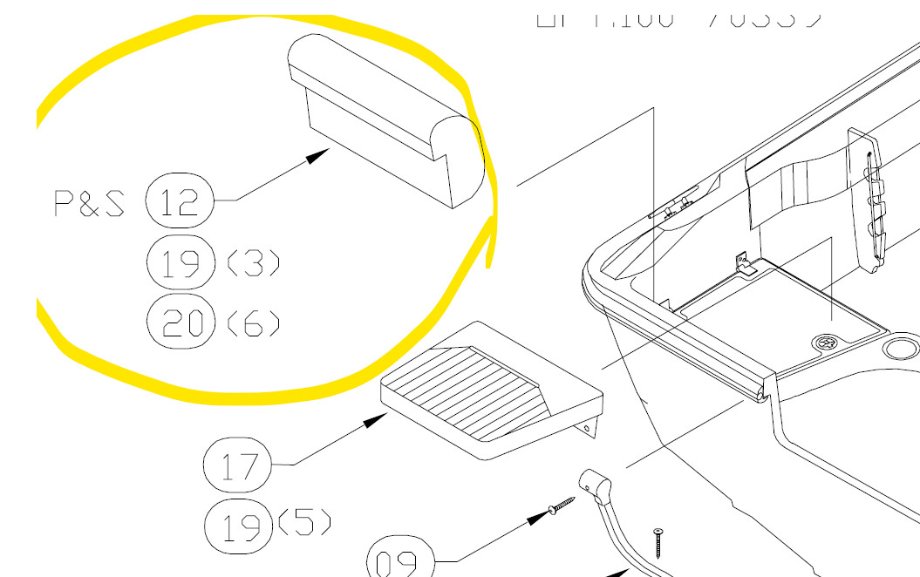

According to the final assembly diagram and parts list for your boat at
https://www.bostonwhaler.com/resources-and-maintenance.html
where you can find lots of other useful info, the aft quarter seat cushions are simply mounted with snap studs. On my 2003 160 Dauntless, these snaps tend to corrode easily and it can be hard to separate them without pulling them right out of the vinyl, so exercise care. A bit of grease or vaseline on the snap when you reassemble it may help you for next time.
