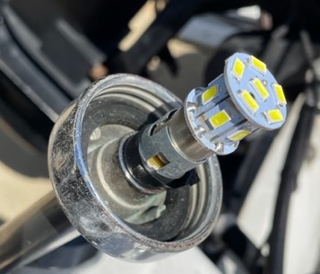

I got the light bulb socket from Specialty Marine. It fit nicely and securely into the circular recess at the top of the light pole.
Fig. 2. Lamp with new socket and LED light bulb.
I got the LED light bulb to fit the light bulb socket also from Specialty Marine

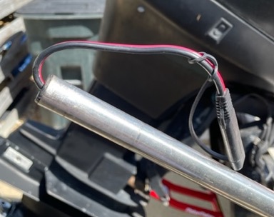

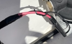

I used automotive or motorcycle connectors for the wiring that I found on a website.
Figure 3. The pre-molded connector spliced onto the original wiring in the boat.
Fig. 4. The pre-molded connector and its wire were used to run up the pole to the lamp.
I used heat shrink to make splices for the wiring at the light bulb socket and at the automotive connectors.
The automotive or motorcycle connectors came with end caps. I thought they were nice to help with weather exposure and corrosion.

I appreciate the information that has been shared about the lightbulb, the light bulb socket, and the connectors used to refurbish the white all-round light pole lamp and its wiring and connectors. I am sure the installation as shown above works and will likely keep working, but it is not the sort of boat wiring that you would find on a boat from a manufacturer that was adhering to A.B.Y.C. standards.
I must point out that the connectors used as described above have several problems:
  • the connectors are pre-molded onto cable and cannot be field-installed on existing cables
  • the connectors have paired pin-socket connectors, and the pin connector is on the red conductor, which would normally be used for positive DC power, and thus the power connector is exposed when the connector is unmated;
  • the connectors can only be spliced onto existing wiring
  • the connectors are genderless, that is, they can make with themselves; if this is done (as appears to have been on the boat described above) then the wire insulation color for the circuit conductors being carried through the connectors switches color every time the connectors are mated to each other.
As a general philosophy about boat wiring, the splicing of conductors should be avoided as much as possible. Every splice is another discontinuity in the circuit which can become a point of failure. On a boat that is only 17-feet long, there could hardly ever been a good reason that a wire had to be spliced to another wire to complete a circuit. If a wire is not long enough, it should be removed and a new wire that is long enough to reach the necessary distance used to replace the original. Wire is not free, but its cost is sufficiently low that you should not have to splice circuits together.
With the wire insulation color changing at every connection point, it becomes difficult to know which conductor is carrying which polarity of the 12-Volt power at any one point in the circuit. The polarity will be a factor if a light-emitting diode light bulb is used; the LED won't illuminate if the polarity of the power is wrong.
The pre-wired light bulb socket is another problem; it will have to be spliced onto other conductors because the wire length is too short to be useful.
Looking at the wiring described above finds the following splices:
  • light bulb socket to pre-wired connector = 2 splices
  • pre-wired connector to existing boat wiring = 2 splices
Four splices have been added to the circuit that otherwise would not be needed if pre-wired connectors and a pre-wired socket had not been used.
A further problem with the pre-wired connectors is the wire: it may not be tinned and multiple-strand marine grade wire, and with fixed wire colors the wire insulation color will be incorrect.
