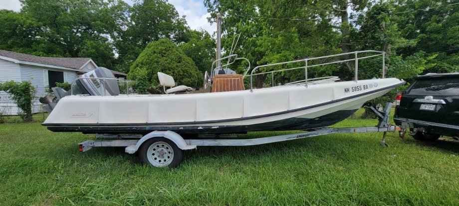

Fig. 1. The 21 OUTRAGE boat that is the topic of this thread, shown prior to being stripped down, the cap split from the hull, and removal of bottom paint begun. The hull and cap will soon have new fiberglass and gelcoat. The console and other teak components will be refurbished.

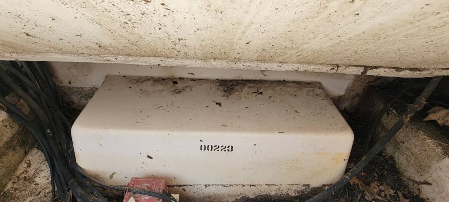

Postby Barclay 71 rib side » Fri Aug 12, 2022 9:21 am
This is the hull #
