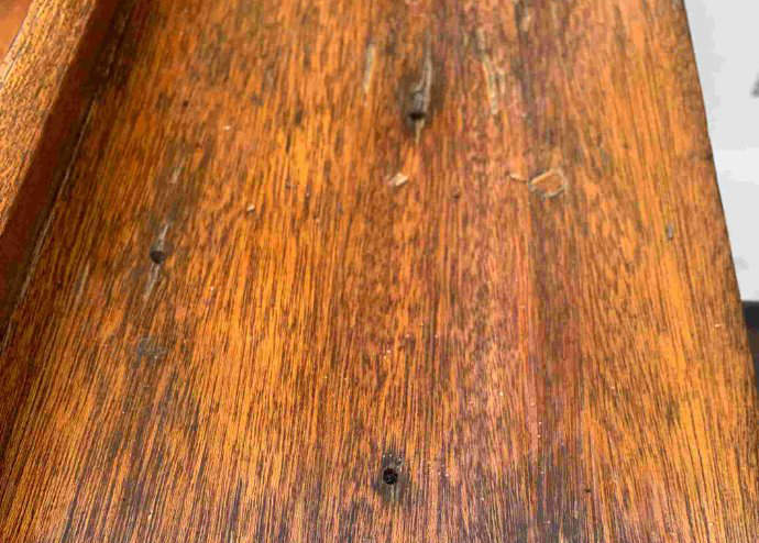

I think the wood on my 1983 SUPER SPORT 13 needs care. I'm not as worried about looks as I am about avoiding rot.
Fig.1.
Q1: does the wood need to be sanded and re-varnished?
Q2: does the wood just need the holes drilled out and sealed?

NYMCAH wrote:Q1: does the wood need to be sanded and re-varnished?
Yes.
NYMCAH wrote:Q2: does the wood just need the holes drilled out and sealed?
No. More care is needed.
Holes for screw fasteners that are no longer necessary should be filled with a bung cut from similar wood using a plug cutting saw. Small bungs or plugs can also be found pre-cut and sold at ship chandleries.

NYMCAH wrote:I'm not as worried about looks as I am about avoiding rot.
Generally the attraction of classic Boston Whaler boats is their use of fine marine woods. To ignore the appearance of the wood is not a good approach to maintenance of a classic Boston Whaler boat. Proper wood care maintains both the appearance and the integrity of the wood.

I recommend to strip that varnish by using a quality scraper and a heat gun.
[I believe a step is missing here. An elaboration would be helpful—Moderator.]
Then apply three coats of Smith's Clear Penetrating Epoxy.
[I believe the author here intends to allow ample time to cure and may also want to perform some additional preparation before the next step. An elaboration would be helpful—Moderator.]
Then follow with five coats of TotalBoat Lust Rapid Recoat Marine Spar Varnish.
TotalBoat Lust Rapid Recoat Marine Spar Varnish can be recoated without sanding. [Read manufacturer’s advice regarding applying quick re-coats for best guidance—Moderator]

After scraping old varnish off with the heat gun and a quality scraper only a light sanding is needed before applying the Clear Penetrating Epoxy Sealer (CPES) if the wood is in good condition. Multiple coats of CPES can be applied without sanding if applied within 12 hours.
I like to do light sand before starting to apply varnish.
Varnishes like TotalBoat Lust Rapid Recoat Marine Spar Varnish can be applied without sanding in between. I find this gives a very good result.
If I were doing a showboat I would use many coats of Epiphanes with sanding between, but not in a boat that will be used in real life.

The wood shown in Figure is not teak. The wood shown in Figure 1 is mahogany.
No one in the history of boats has ever used teak oil on mahogany and lived to tell about it.
