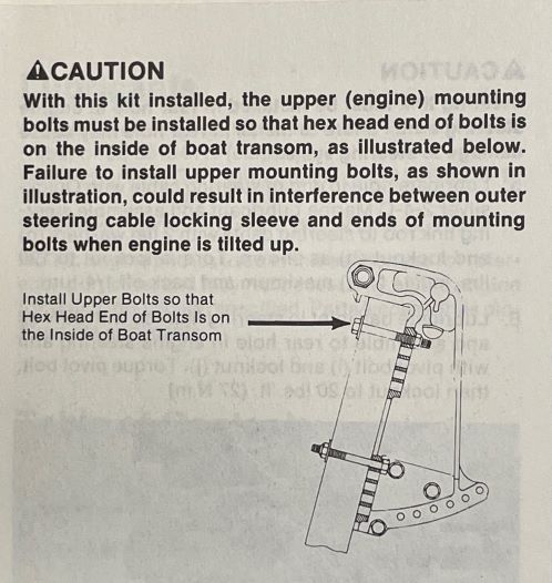

The OEM service manual for my 1990 Mercury 90-HP outboard engine is quite specific regarding the orientation of transom mounting bolts. Here is the diagram on page 7A-2:
Note that in the diagram (and in numerous photos throughout the manual), the lower bolts are oriented with the nuts inside the boat. The manual does not comment on the reason for this, but I suspect it was to reduce the risk of interference between the engine mounting bolt and the bolts that secure the transom bracket to the power trim assembly (especially the top power trim bolt, which is quite close to the engine mounting bolt, as shown on the diagram) if the top hole of the mounting bracket is used. On my own boat, the dealer did use the top hole in the lower part of the bracket, and he oriented the nut to the OUTSIDE of the transom. When I went to remove this bolt in preparation for installing a jack plate, the proximity of the head of the upper power trim assembly bolt prevented me from using a socket wrench on the engine mounting bolt nut. (When I installed the motor to the jack plate, I used the hole one below the previously used one so that this wouldn't be a problem.)

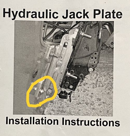

Interestingly, the installation instructions for my Atlas Micro hydraulic jack plate says the following:
"It is recommended when possible to insert bolts from inside the Atlas Micro plate through the transom...".
I am sure this recommendation is to minimize the risk of contact between the mounting bolts and the mechanism of the jack plate. However, I suspect someone in the company recognizes that customers are used to seeing bolt heads and not nuts inside the transom, so a photo in the instruction sheet shows an alternative mounting scheme:
