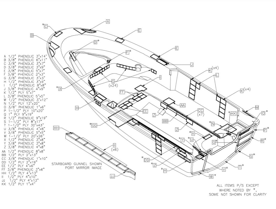

Please do not do this, [that is, do not cut a hole and dig out foam before through-bolting a trolling motor at the bow].
Q5: have you checked the backing diagram to see if there is already reinforcement in the bow?
In specific areas there is phenolic (like starboard) material embedded in the fiberglass to provide backing reinforcement.
Here is the diagram for the 2010 model year Outrage 190.
Fig. 1.
Ref: https://www.bostonwhaler.com/content/dam/boston-whaler/technical/resources/190-Outrage-Wood-Locating-Diagrams-2010.pdf
Q6: what model year is your boat?
If there isn't any reinforcement, there is another method, albeit not as straight forward as toggle bolts that is recommended. It is referred to as the "hockey puck" method. This method is obsolete and has been replaced with the stainless toggle bolts.
At each fastener location, drill a 0.33-inch hole, dig out the foam with an Allen wrench. Tape off the deck three inches around the hole. Insert Gorilla Glue, an expanding polyester based epoxy glue. Allow it to expand. Fill again till it overflows out of the hole. Let cure. Trim excess.
This is the puck. Tap for the fastener.

Phil, thanks for the above drawing showing the phenolic reinforcement. My boat is a 2007. Those locations probably have not changed.
Q7: would there be any change of opinions if I used a gel battery in the anchor locker?
I will consider putting the batteries in the cooler if necessary. I am rarely accused of being [obsessively preoccupied by inconsequential elements,] but I really [do] not like anything in the [cockpit deck] of my [OUTRAGE] boat.

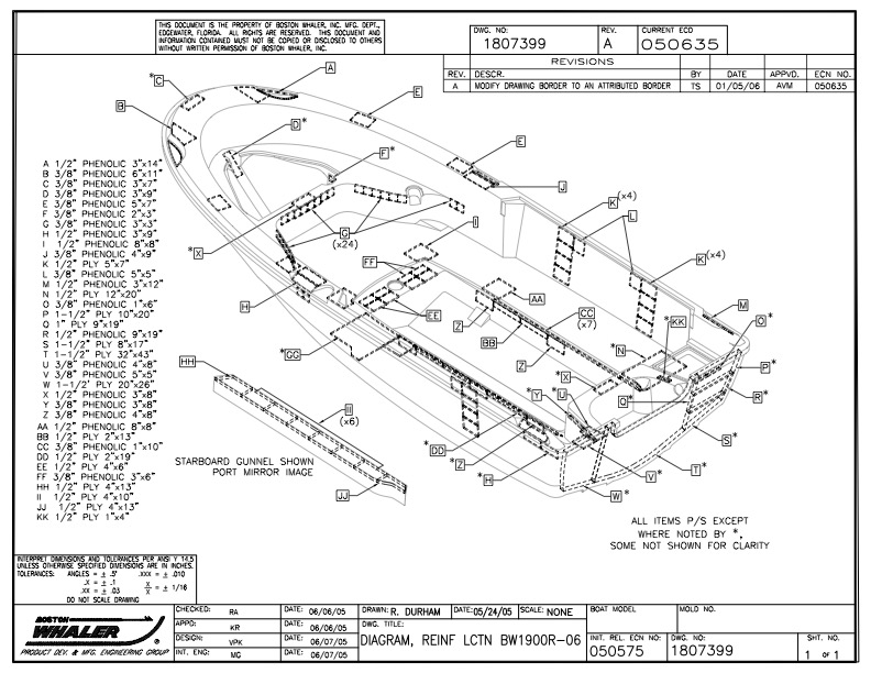

This is the same drawing and has a date of 2005:
Fig. 2.
There were very few hull changes in this model.

If you drill in an area that has phenolic backing, you do not need a toggle bolt. The backing is what adds the necessary strength. A machine screw is recommended.
The toggle bolt or "hockey puck" is only for locations where there is no embedded backing.
