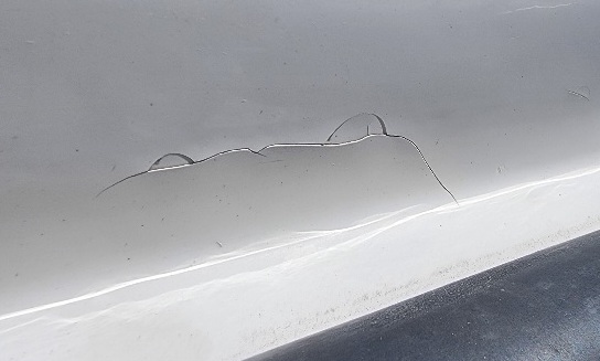

My 2008 OUTRAGE [of unspecified length--please include the length designation of any boat you wish to discuss] has series of cracks with delamination and peeling of gelcoat on the gunwale. When I bought this boat in 2021 a surveyor told me these defects were cosmetic and caused by the boat hitting a dock.

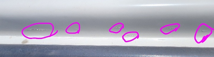

Fig. 1. Overall view of some damage areas which are circled with large violet markings on the image.

During heavy use of the boat, no further cracks have developed, but the existing cracks are becoming delaminated from the hull. When I push on the cracks the gel coat breaks. I want to repair these cracks. I have the Spectrum gel coat kit.
Q1: should I repair the cracks in the same manner as a gel coat spider crack?
Give me advice for repair.

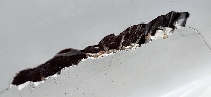

Fig. 3. Enlarged damage after using Dremel too.
I used a [Dremel] tool to clean up the bigger crack.
Q3: does this damage need glass work?
Q4: should I continue until all voids are exposed and fill with gel coat resin?

Also, the damage probably was caused from hitting a dock. They could also have been some forward motion on the boat when it hit the dock, the damages seem to be in a line, as if the boat was moving forward somewhat at the time of impact. I would not call the damage just cosmetic because it exposed the underlying laminate layers and creates an opening in the hull where water could enter. Cosmetic damage would he damage that was limited to just a scratch into the surface of the gel coat layer. This damage has clearly broken away the entire gel coat layer and exposed the laminate layers.
There may have been some voids in the hull in the original manufacture, and that is why there appears to be an air gap between the gel coat layer and the laminate, or the gel coat layer has moved away from the laminate after the impact. The gel coat layer should be strongly bonded to the underlying laminate layers, and that bond does NOT seem to appear in the close-up images.
These areas appear to be in a high-visibility part of the boat, so you will want to make the repairs blend into the hull as much as possible. Using the Spectrum gel coat patch kit resin should give you a good color match. If you are not skilled in using resins to make repairs, you should first attempt a repair to a not-so-visible area of damage.
The damage shown in Figure 3 looks rather deep, but it may be just the photograph is a very extreme close-up view. In that image the gel coat looks like it did not have a good primary bond to the underlying laminate layers. The laminate layer looks very dry.
