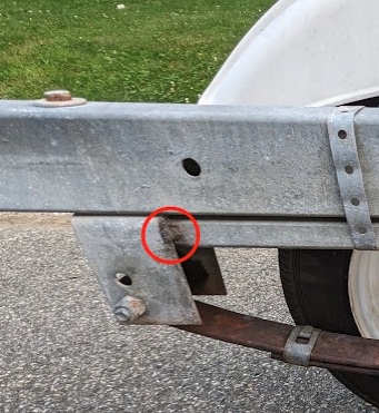

Give me a solution to fix or repair or modify a spring hanger from a 2001 E-Z-LOADER trailer as seen below in Figure 1.
Fig. 1. A spring hanger bracket as seen on a 2001 E-Z-LOADER boat trailer.

The boat trailer spring hanger bracket seen in Figure 1 above is made of steel. Steel can often be welded to repair cracks or other damage. Your illustration does not show much detail or where there is damage, but it certainly looks like a weld could be redone to restore the part's strength.
The unique part of this spring hanger bracket is the inclusion of [unseen] welded-on hangers to mount the trailer fender (based on the OEM catalog page showing the part in full).
You can probably find a replacement part for the spring hanger bracket from generic trailer parts or other E-Z-LOADER parts. Every boat trailer using leaf springs will have a similar bracket for mounting the spring to the trailer frame. The principal variable would be the width of the trailer frame that the spring mounting bracket needs to mount onto. This part could be welded onto the undamaged portion of the original assembly.
Re-mounting the fender could also be done with some improvisation using off-the-shelf fender brackets
As can be seen in Figure 1, most of the loading on the trailer spring mouting bracket is in compression against the trailer frame member above it, along with some lateral forces from the spring acting on the bracket to move if forward or aft on the trailer frame member.

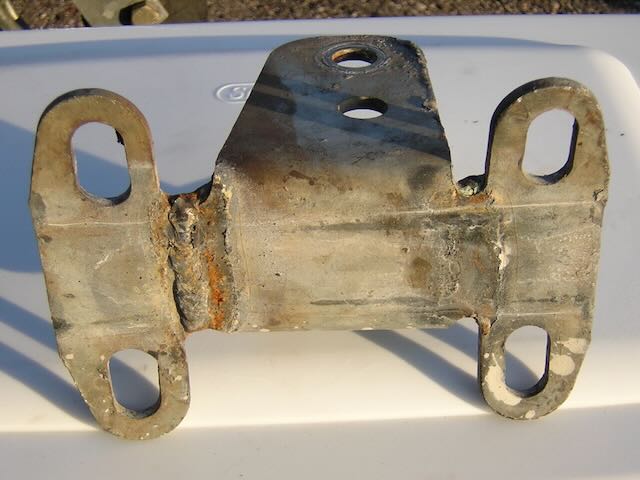

Similarly, the repaired bracket seen in Figure 2 is also being acted upon mostly by compression, and the welds really are not involved in that stress. The welds connect the mounting tangs by which the bracket is maintained on the trailer frame fore-and-aft.

Fig. 2. A trailer spring hanger bracket from a 1992 E-Z-LOADER boat trailer after repair by welding.

Given the importance of this piece of hardware, I would not trust welding as it requires the removal of the galvanization. The galvanization material is highly toxic. Also note that the galvanization process penetrates the metal so its full removal is highly difficult. Welding requires the proper materials and will often lead to a contaminated weld.
