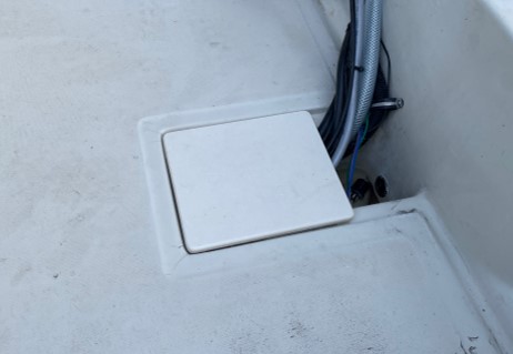

Figure 1. Whaler sump cover constructed with Corian®
Whaler sump cover.jpg (20.9 KiB) Viewed 3454 times
My Whaler came with a cheesy plastic sump cover that was screwed into the deck. I removed it, filled the screw holes with Loctite Marine epoxy, and installed a sump cover made from Corian® held in place with heavy-duty Velcro. It’s still holding firmly a year later.

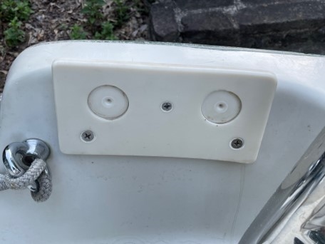

Trolling motor mount milled and thermoformed.
Whaler trolling motor mount.jpg (51.63 KiB) Viewed 3454 times
I occasionally use a trolling motor when fishing, but I didn’t want one permanently installed. I had been using a motor clamped on at the transom, but it sometimes slipped while in use. I fabricated a motor mount by drilling out a piece of Corian® with a Forstner bit the size of the motor clamps. There is a gentle curve on the inside of the transom, so I thermoformed the mount after milling it by placing it in my oven for 40 minutes and then clamping it to the transom before it cooled. The mount has held up nicely, and the trolling motor no longer slips. (You can find the instructions for thermoforming Corian® here: https://casf.com.au/wp-content/uploads/ ... 12-ENG.pdf)

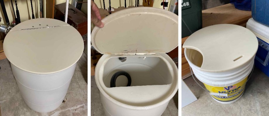

Baitwell covers constructed with Corian®
Whaler baitwell covers.jpg (58.7 KiB) Viewed 3454 times
I wanted a removable circulating baitwell that I could install behind the reversible pilot seat, so I constructed one using a plastic barrel I had on hand, topped with a piece of Corian®. I liked it so much I made another top (patterned after one sold by Boat Outfitters) that fits on a 5-gallon bucket.
