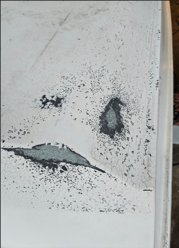

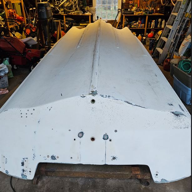

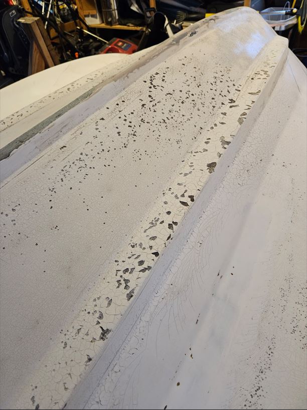

I have a 1969 [unidentifed model and length of Boston Whaler] boat that I've owned since 2017. I have been wet-slipping the boat for the past several seasons and noticed that the gelcoat was blistering significantly below the waterline. This winter, I am working on repairing the hull blisters.
I removed the boat interior, and the hull is upside down in the garage. I gave the entire bottom below the waterline an initial sand down the blisters, and to size up what I'm working with.
See photos below.
Q1: What would be the best course of action going forward?

Given the extent of the hull rash, a repair that attempted to work only on isolated individual areas would not be a good approach. In addition to blisters the hull has crazing and cracking.
The best method may be to sand the entire hull bottom and sides, removing all the defects.
Areas with deep depressions and pits may need to be filled with epoxy resin mixed with a filler. Then carefully sand the epoxy areas to be flush or fair.
Be very careful when trying to sand fair the cured epoxy resin-filler areas. Your sanding will tend to remove old gel coat resin much faster than hard cured epoxy resin.
Follow on using a fairing compound to fill small depressions .
When the hull bottom is repaired and faired, it will be ready for application of a top coat or two.
