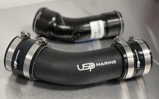

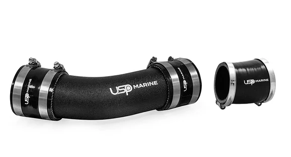

jimh wrote:Q3: how much was the replacement part as an OEM part from Mercury Marine?
The kit I bought from USP Marine was $189 and included both the long pipe and the smaller coupler. The only OEM part I was able to find online was $118, and it was a stiff plastic hose and did not include the smaller coupler (included in the USP Marine kit).
jimh wrote:Q4: was the replacement part a molded plastic pipe or assembly or a flexible hose?
Both the OEM and USP Marine parts are aluminum pipes wrapped in a wired mesh and silicon outer layer. The USP Marine kit also came with stainless steel, reusable clamps to replace the aluminum one-time use clamps from the OEM part.
Fig. 1. The USP aftermarket part (foreground) and OEM part (background). Note the difference in the clamps used.
Fig. 2. The two components in the USP Marine kit and supplied clamps.
