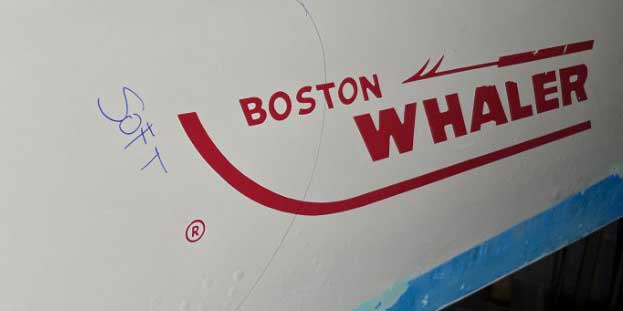

The hull sides on Port above the water line at the stern have multiple blisters, and the hull sides are soft in an area near the Boston Whaler harpoon logo. The hull also has several small gouges in the gel coat layer which exposed the laminate below.
Fig. 2. Port hull side soft area.
Q1: should more test holes be drilled in the transom?
Q2: should more test holes be drilled into the hull bottom?

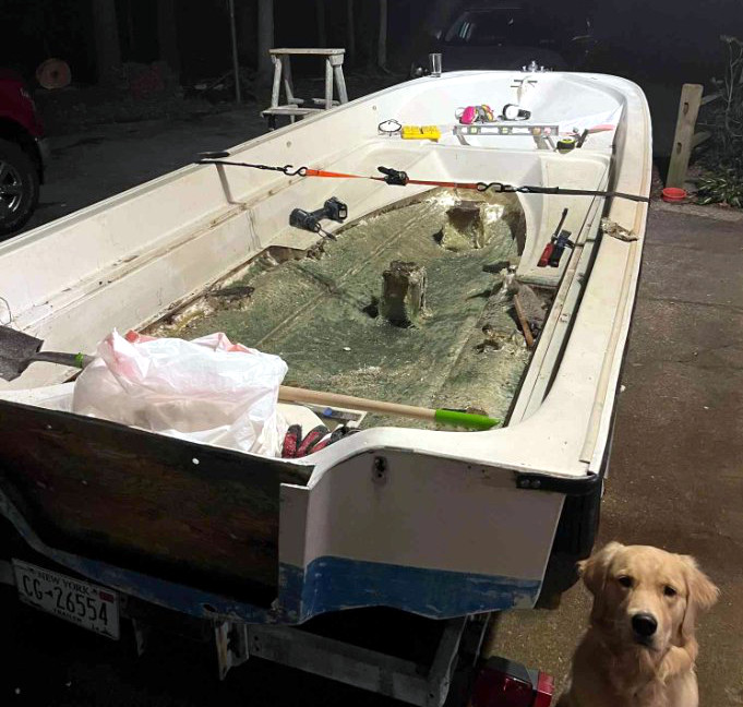

Fig. 3. A SUPER SPORT 15 viewed from astern.

The boat seen in Figure 3 does not quite exactly look like a SUPER SPORT 15. It looks like a SPORT 15 with a high seat back added to the bench seat. A SUPER SPORT 15 should have a seat back that is formed by a storage locker.
Also, the console height seen on your boat looks a bit taller than the normal console in a SUPER SPORT 15.

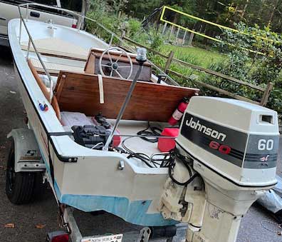

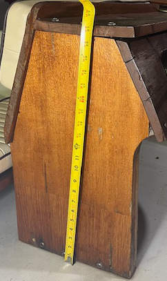

My 1985 SUPER SPORT 15 looks like the console was raised seven inches; see Figure 4 below.
Fig. 4. Modified console raised seven inches by addition of riser on lower end of support leg.

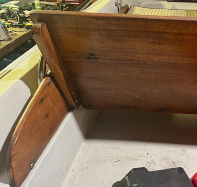

The storage cabinet looks to have been removed as well. There are mounting holes on the back of the seat that seem appropriate for where the storage cabinet would be.
Fig. 5. Holes in seat back were the storage console might have been mounted.

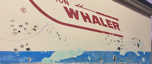

I opened the blisters on the hull side on Port; a small amount of moisture came out.
Fig. 6. Blisters on hull on Port side.

While osmotic blisters were quite a problem for many fiberglass boats in the 1980's, I do not think hull blisters were particularly common on Boston Whaler boats.
The raising of the side console on the SUPER SPORT 15 is quite interesting. Many people have raised the center console on their OUTRAGE or MONTAUK boats, but I do not recall hearing of anyone raising the console on the SUPER SPORT 15. The work looks well done in Figure 4 as the joint line is barely visible.

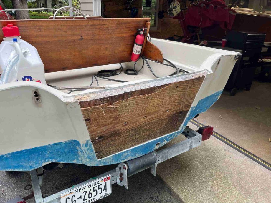

The transom was removed, and the plywood was found completely saturated.
Fig. 7. The embedded wood reinforcement in the transom was found to be wet.

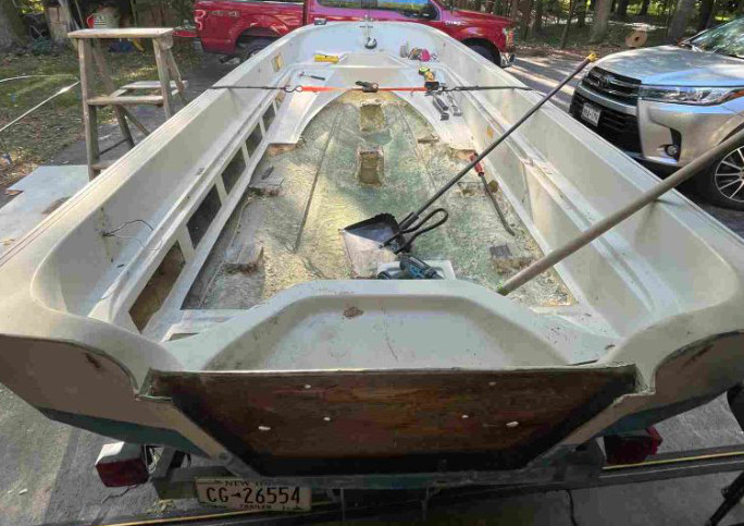

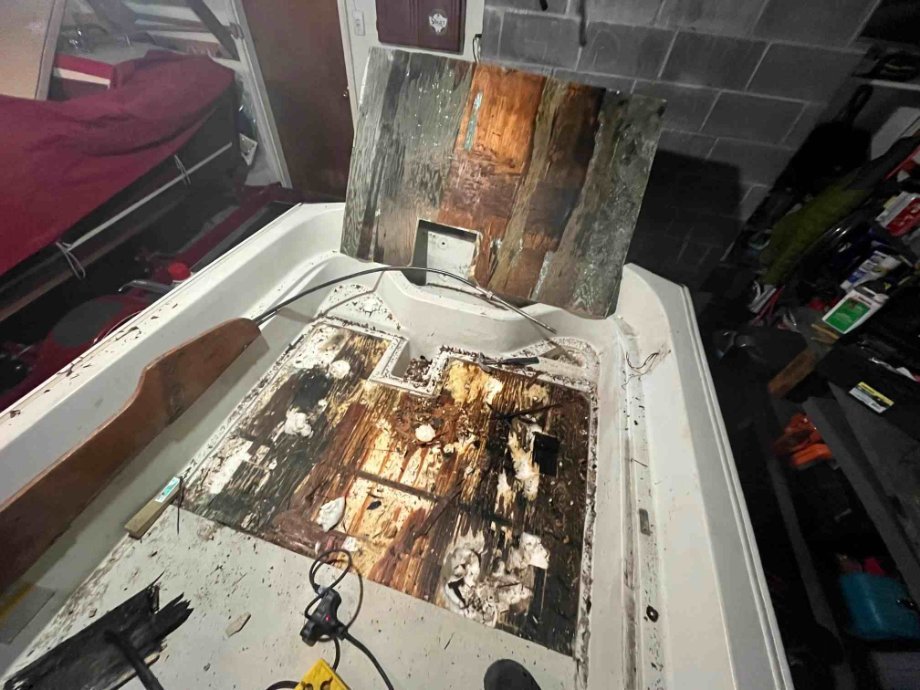

I cut a small test hole on the interior and also found the foam to be completely saturated. I decided to remove the floor, working towards the bow.
Fig. 8. The cockpit deck has been cut out. The embedded wood and foam were found to be wet.

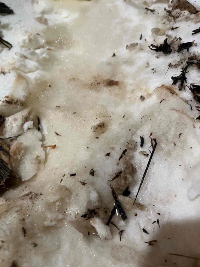

The amount of saturated foam was unbelievable. The entire hull from back to front was found soaking wet.
Fig. 9. Extreme close-up view of wet foam with wood shavings.

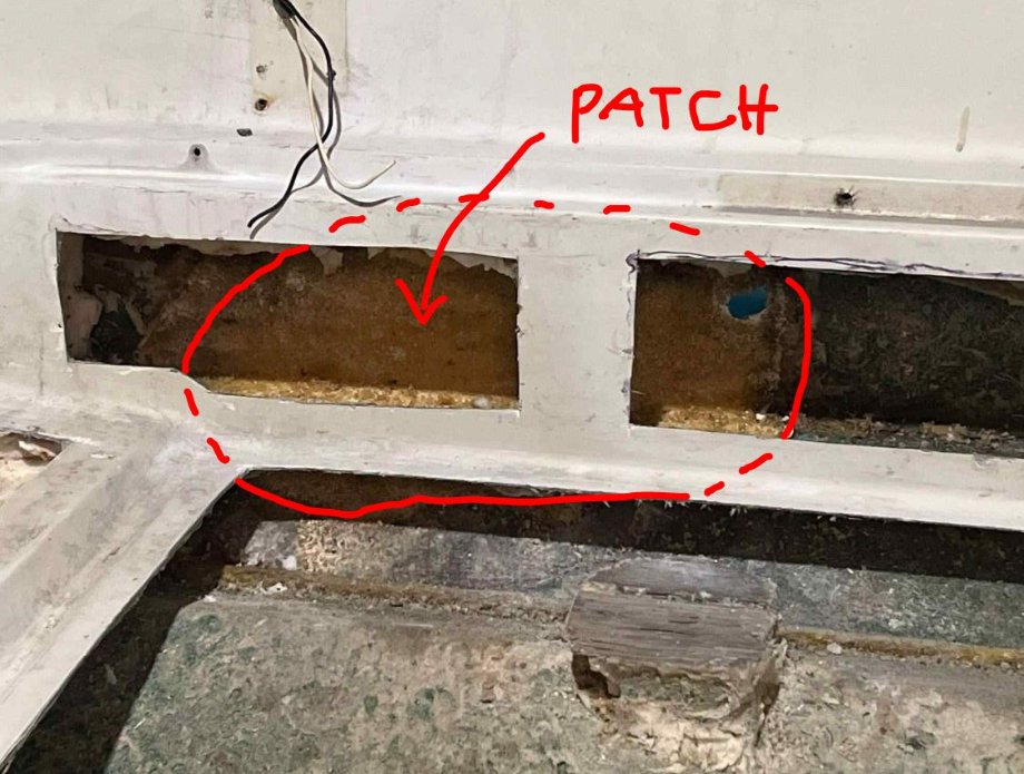

[Figure 10] shows the area of the poor patch. [Moderator's note--please explain further this comment is not clearly stated.]

My first reaction to this new update is to be quite astonished at the extent of ingress of water you have found in the interior of the Unibond hull. The source of the water must have been below the waterline and subject to significant water pressure resulting from the hull running at speed through the water to force that much water into the hull.
Second comment: Figures 10 and 11 are very interesting because they show an element of the construction of a Unibond hull that is seldom seen: the shear braces.
The shear braces are structural elements that connect the hull molded part with the hull liner molded part when the two parts are joined together in clamped molds and the space between them is filled with foam. In Figure 10 you can see the remains of a shear brace that has some of the plywood reinforcement still attached to in; in Figure 11 you can see what appears to be a shear brace in the middle of the hull that has been left in place.

If you try to introduce new foam after the cockpit deck has been restored, I doubt it would be successful. In the original process of creating a Unibond hull the two parts, hull and liner, are still in their molds, and the molds are made to be clamped together. The expansion of the foam is limited by closing off the sprue hole. This limits the expansion and produces a higher density foam than would occur if the foam were allowed to expand against open air. Also, the pressure of the expanding foam might distort the shape of the liner or huill.
One way to recreate the higher density foam and to avoid any distortion of the hull or deck is to purchase already cured foam in blocks or sheets. Then individually cut and shape pieces of the higher density foam to fit the shapes in the hull as best as possible while the cut-away deck sections are not replaced. That will be tedious, for sure.
Use an adhesive (like thickened epoxy resin) to secure the new foam to the hull. When the epoxy resin has fully cured and the new foam is firmly fastened to the hull, then you could sculpt and fair the foam at the cockpit deck surfaces and cockpit inwales to be fair and level.
For the deck you could bond the new plywood to the foam with more epoxy resin. Then finally replace the laminated deck sections you cut off to gain access, again bonding them in place with thickened epoxy resin. For the cockpit inwales the cut-out laminated portions would be bonded to the new foam.

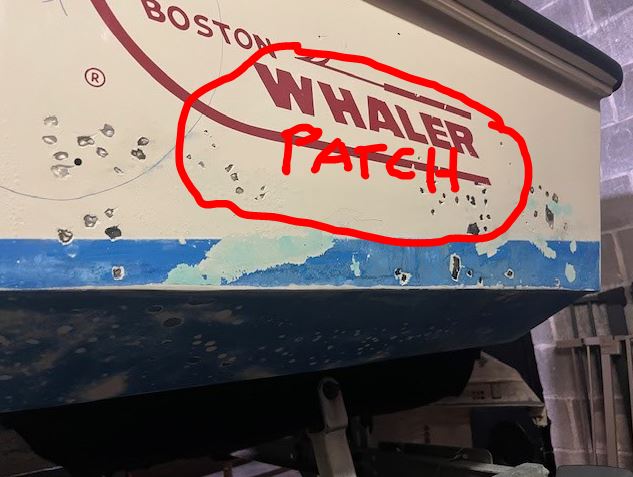

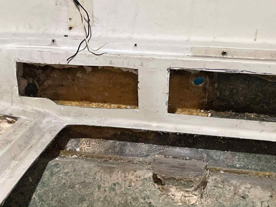

To clarify Figure 10, the yellow color in the photo is not foam, but a previous fiberglass patch (not by me), which appears to be there to repair damage. I bet this is where the extreme amount of water came in.
Fig. 12. Encircled area is a where repair to the hull sides was done previous to purchase of the used boat.
Patch Interior.JPG (125.29 KiB) Viewed 1302 times
Fig. 13. Encircled area where a repair to the hull sides was done previous to purchase of the used boat.
Patch Exterior.JPG (50.61 KiB) Viewed 1302 times
I didn't weigh the saturated foam, but I bet I removed over 300-lbs of wet foam.
