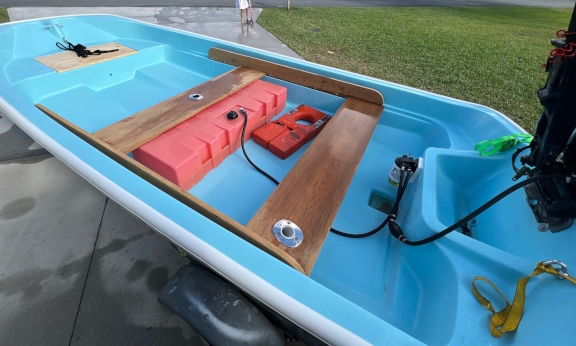

Recently I bought a 1998 Boston Whaler 13-footer for my son. He is interested in adding a center console, mainly to have a proper spot for a steering wheel, radio, speakers, boat battery, and a SONAR. We've looked at some of the traditional wooden side consoles, but he’s leaning toward a fiberglass center console with a forward-facing seat that could also function as a live well and cooler.
We are not sure how these boats are constructed.
I’ve seen youTube presentations in which people use adhesives to mount parts on a 13-footer. While I understand that can work, we’d prefer to minimize adhesive use in case we ever need to remove the console down the line—we don’t want to damage the deck unnecessarily.
Fig. 1. The 13-footer under discussion.

I do not recall that Boston Whaler ever provided a center console version of the 13-foot hull. I suspect that might be because the beam of the hull was not sufficient to have a center console and still afford room to get around the center console.
If you must have a center console, it would probably need to be a very a narrow design.
In the CETACEA collection of photographs a 13-foot hull with a homemade wooden center console is shown at Page 21:
https://continuouswave.com/whaler/cetac ... age21.html
When that CETACEA page initially appeared there were comments about the design of the center console for the 13-footer and its appearance. The comments were universally negative.

I now have realized that we have a 1998 Anniversary Edition Super Sport [13]. I am not sure if the seller understood this when they sold it.
I have confirmed the ID number on the boat. I am now thinking we should preserve this and keep it as original as possible.
Q3: what is your opinion on keeping the 1998 Anniversary Edition Super Sport as original as possible?

To keep the boat in its original condition is the best decision you could have made.
But as seen in Figure 1, there are some parts missing from your boat: side console, railings, original anchor locker hatch.
Compare at
https://continuouswave.com/whaler/refer ... .html#40th
