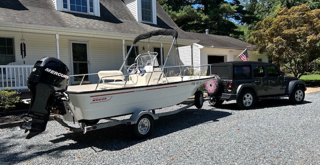

I have a 2008 170 Montauk with the factory Karavan trailer (BW-2350-74); this is the trailer without brakes. I bought the boat, motor and trailer new in 2008. I replaced the wheels and tires last summer but decided to hold on replacing the hubs...that was a mistake.

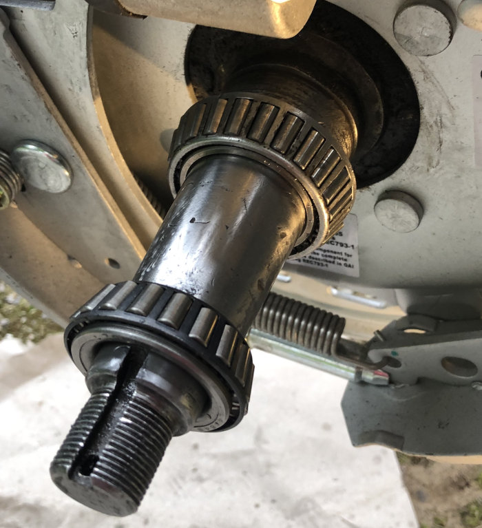

The right wheel bearing went bad on the way to the marina. Limped off the highway but by that time the damage was done...the spindle is gouged.
I've removed the axle from the trailer. The Karavan parts diagram (and the label on the axle) indicate part number 310-02060 for the axle assembly. I've Googled around and have not been able to find that part number or a cross reference. I was hoping to find a direct replacement but also checking the trailer parts supply websites.
Fig. 1. The identification sticker on an axle showing the number give in the text of this article.
Fig. 2. The damaged axle spindle.

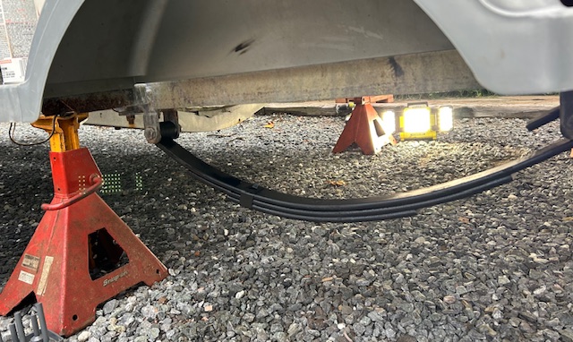

Fig. 3. Orange cones placed around trailer while supported on jack stands.

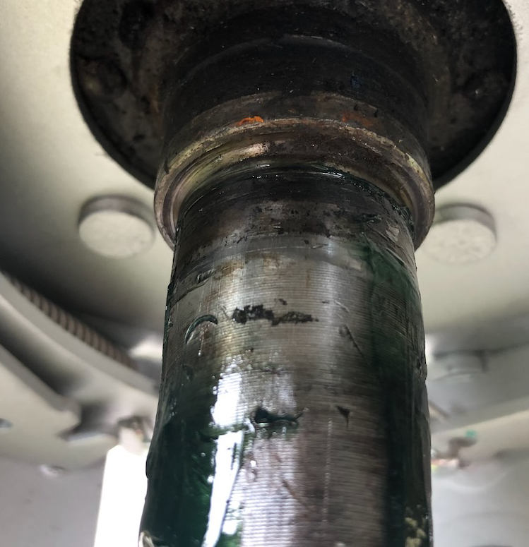

The damage to the spindle on the axle may be able to be fixed, at least temporarily. Typically the only components that actually touch the spindle are the races of the two bearings. If you can grind down the gouges on the spindle while preserving the slope, and if the bearing races can properly slide into position, the axle should be useable.

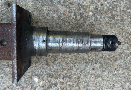

I had a very similar situation on my boat trailer: one spindle on one axle was gouged when the bearing failed completely in a quite unexpected manner. I used a small die grinder attachment to a DREMEL tool to remove the burrs from the gouges on the tapered spindle to allow new bearings to be slipped over the spindle and properly seat their tapered races onto the spindle. It took a bit of time to do this, but so far, that axle and those bearings are behaving normally.
Fig. 4. A similarly damaged spindle on a different trailer.
Fig. 5. Refurbish spindle. A die grinder was carefully used to remove ridges in the gouges. The spindle was sanded with fine-grit emery cloth, then wet-sanded with WD40 to restore a smooth surface. The bearing races were test fitted during this process to check for proper profile and fit.

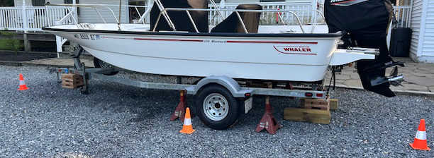

I appreciate the concern but without a working wheel bearing on the trailer...it's stuck in my driveway until I can make the repair.
Recognizing the the risks involved, I went a bit overboard in terms of jacking up the boat. I used four 5-ton Snap on jack stands under the trailer, along with wood cribbing under the springs when I removed the axle. I also had some 6x6 blocks in different places as a back up.

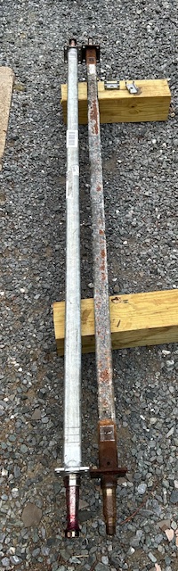

The first thing I did was to compare the two axles. The distance between the brake flange was only different by a 1/4" at most. The overall length is about the same. I used a sharpie to mark the spring location and spring center. The axle I purchased included a set of spring seats.
Fig. 1. Comparison of old and new axles. The spring seats are sitting on the block of wood on the left side

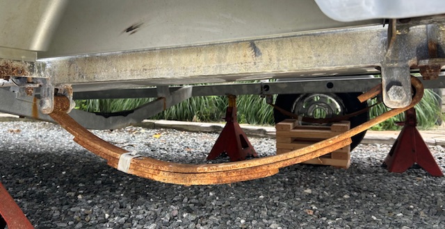

The leaf springs were a bit rusty. I decided not to buy new ones. Instead, I removed the leaf springs and hit them with a wire wheel attached to a hand drill. The cleaned up nicely. I sprayed them with a coat of "rust converter" by Rust-oleum.
Fig. 2. Leaf spring with surface rust
Fig. 3. Leaf spring reinstalled after being treated by rust converter

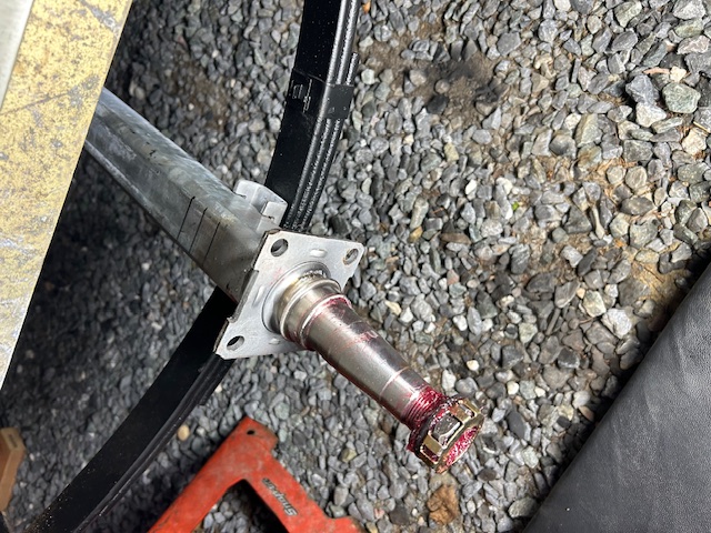

Postby chuck21401 » Thu Aug 07, 2025 4:12 pm
After I reinstalled the leaf springs, I carefully positioned the axle on the spring seats. The axle lined up nicely with the markings.
Fig. 4. Axle placed on spring seat which is resting on the axle.

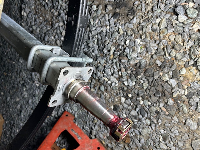

The next step was to install the U-Bolts.
Fig. 5. Axle attached to leaf spring with U-Bolts.

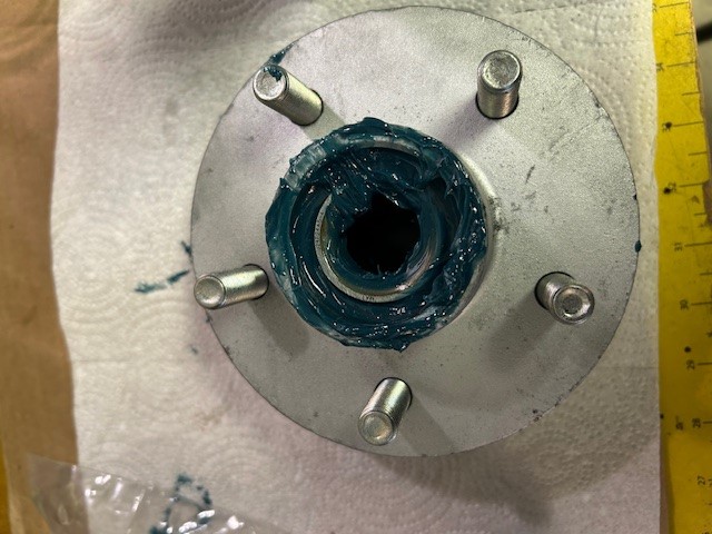

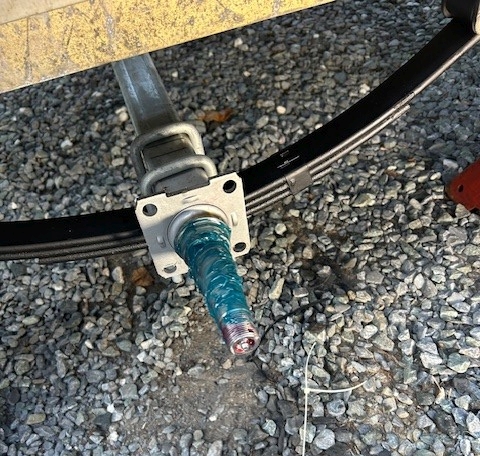

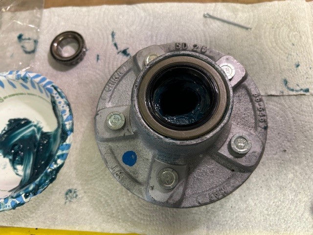

I watched a couple of YouTube on how to pack trailer wheel bearings and decided to proceed. I did see a couple of videos featuring a bearing packer. I used plenty of grease.
I packed the rear bearing full of grease and tapped on the seal with a block of wood.
Fig. 1. New galvanized hub with rear bearing and seal installed.
Next I packed the front bearing full of grease and installed in the hub.
Fig. 2. Hub with front bearing installed
Then I added more grease to the spindle.
Fig. 3. Axle spindle with plenty of grease

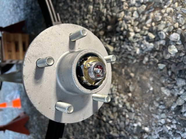

Mounting the new hubs on the spindle involved several steps.
Rather than a castle nut on the end of the spindle, the new axle uses spindle nut with a "spindle nut cage." It took me a couple of minutes to figure out how these work. So the hub goes on the spindle, followed by a flat washer, then the nut. Once the nut installed...the cage goes over the nut...then the cotter pin is installed.
Fig. 4. Hub installed on spindle. Flat washer installed, followed by spindle nut, cage and cotter pin.

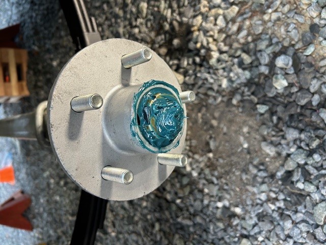

Once the hubs were secured, I added even more grease.
Fig. 5. Hub installed, more grease added.

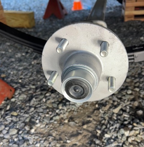

For the last step I installed the dust covers. Used a wood block to tap them on.
Fig. 6. Hub with dust cover installed.

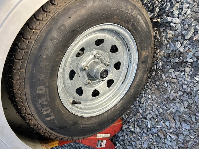

The last step was to mount the wheel and tire...and repeat this sequence for the other side of the trailer. Then I carefully jacked up the trailer and remove the jack stands.
Fig. 7. Wheel and tire mounted on hub.
From there I took the trailer for a test drive. I used an infrared thermometer to check the temp at the hubs...in the mid 90s degree Fahrenheit.
Fig. 8. Repair completed; test drive went well

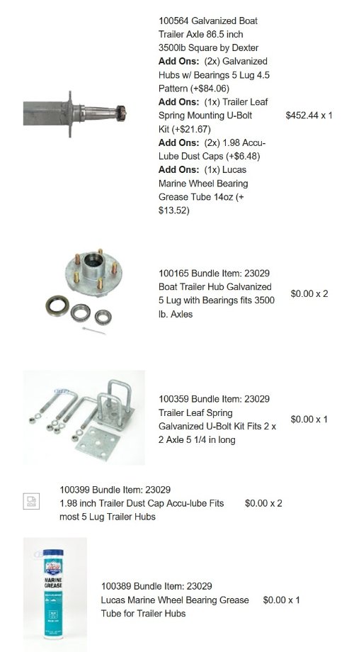

Here is the parts list in case it is helpful to others in the future.
Fig. 9. Parts used in this project. The axle included spring seats though not mentioned in this list.
