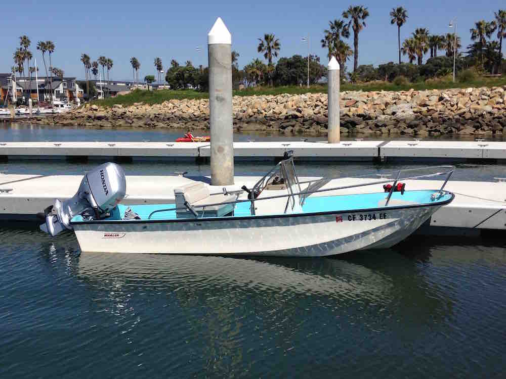

To conclude this thread I ended up going with a Honda 90, the price was relatively comparable in the end for the full re-power:
(full re-power price, outboard+install, removal or old engine, harness-gauges-throttle/steering-prop etc.)
Prices are from southern CA.
Yam: 10k
Etec: 12.5k (may be a bit high, local dealer seemed expensive)
Honda 12k
I know Etec is a favorite here, but based on talking with local dealers I went Honda based on my trust of the dealer which was a big factor in my decision. I know I would have been happy with either motor. The reason I ruled out the Yamaha was the lower HP(possibly a problem when fully loaded with people, surf and dive gear, and why drop 10K and risk wishing I had more power) and shorter warranty. The Etec 10 year warranty is really impressive but Hondas also have a good reputation for running a long time and have a standard 5 year warranty. I don't think there is a wrong choice among these engines.
Engine is great, boat is fast and doesn't seem to mind the weight with the 24 gallon tank and batteries midship.
