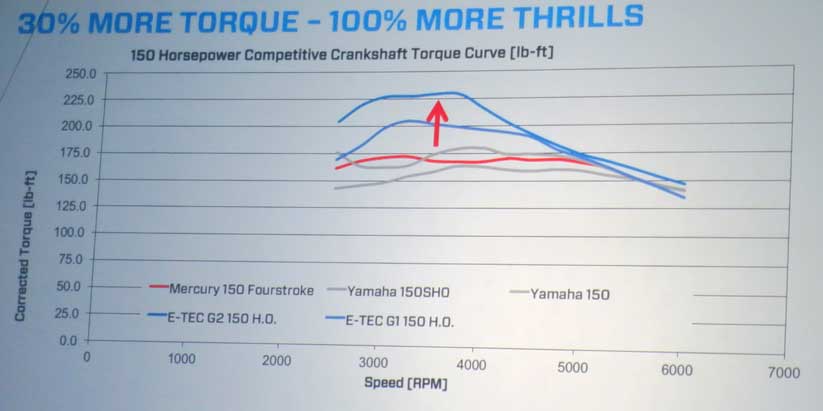

Regarding the power or torque curve for the E-TEC G2 66-degree block engines, a slide was shown at the dealer reveal that plots crankshaft torque as a function of engine RPM for the E-TEC and several competitor engines. I reproduce the slide below:
Evinrude Presentation of E-TEC G2 V6 66-degree block engine torque curve
The graph (above) shows that the E-TEC G2 66-degree block engine will produce substantially more torque than the Mercury 150 FOURSTROKE (NOT VERADO) engine.

Re the difference in torque between the E-TEC G2 74-degree and 66-degree engines: I am sure the larger displacement of the 74-degree engines will deliver a wider power band. The weight difference in the DPS models is not particularly large. I think it's only about 20-lbs. I'd have to research it more to get the exact figure.
