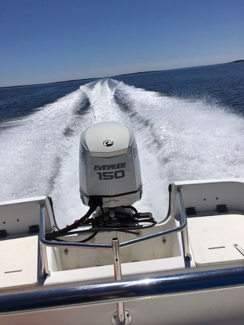

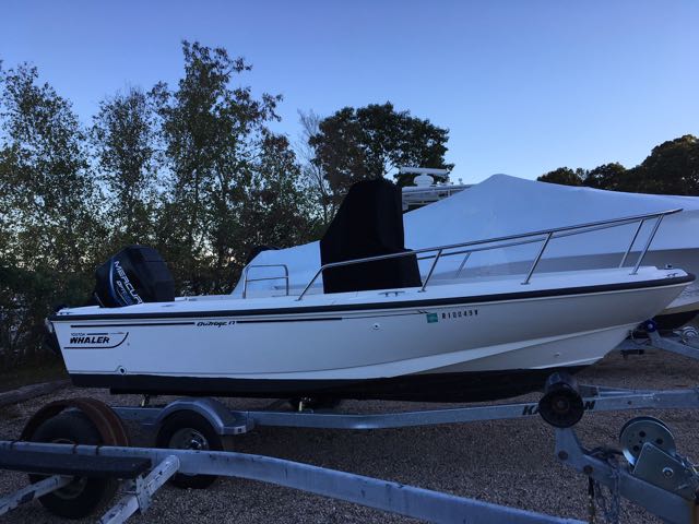

Two photos from Gobuck:
new boat.jpg (60.22 KiB) Viewed 6678 times
1st boat ride with new motor - Copy.jpg (42.65 KiB) Viewed 6678 times
