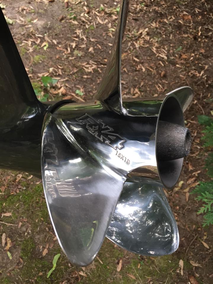

Gents—I will be re-powering my Outrage 22 Whaler Drive with an E-TEC G2 225 H.O. The dealer has recommended an Evinrude RX4 15 x 18-pitch propeller and has carried that propeller in the quote.
I currently have a 1988 Evinrude 225 that used push the boat to 41 to 42 MPH with a 15-pitch Stiletto propeller.
I am interested in your thoughts (or experiences) if the RX4 18 pitch seems to be a good starting point. The gear ratio is 1.85/1 and the RPM range is 5400 to 6000

I’m not a real big technical type when it comes to specifics regarding propeller efficiency and things like that. I’m very satisfied with this prop. With My old 1985 Yamaha 225 HP with a 3 blade stainless prop would push my revenge 22 walk-through with a full load at about 41 mph give or take a little. This Evinrude E tech G2 225 HP Is a whole different animal. The boat just jumps out of the water. On the test runs with Lockmans we drop the boat in the Detroit River and the first run upriver against the current we did about 54 mpg at about 4500 RPMs and it still had plenty of pedal left. That was plenty good enough and plenty fast enough for me. --I laugh aloud--
I read it as RX4 15x18

Ran the boat for the past few days. The Evinrude E-TEC G2 225 H.O. needs less propeller pitch. Right now the prop is an RX4 18" pitch.
The maximum speed the engine could accelerate to was 5310-RPM, and boat speed was 46.5-MPH. The boat was porpoising; when I trimmed down to stop porpoising, engine speed dropped to 5250-RPM and boat speed was 45.9-MPH. The boat was lightly loaded--just me, my cousin, and 60-gallons fuel.
At 3000-RPM boat speed was 22.7-MPH
At 4000-RPM boat speed was 34.8-MPH.
I didn't take any fuel flow numbers due to coming prop change.
With that being said, the engine was a blast to drive: acceleration was better than ever; and I loved almost everything else about the engine. I don' if I am a big a fan of trim--maybe I'll get used to it. The engine seems to trim up a little too much and I have to trim down to stop the boat porpoising.
I'm not sure the RX4 16" pitch will get me near 5800.
I would love comments or suggestions on new propeller selection.

If you can borrow one for testing, try a REBEL 17-pitch. You can see some performance data I collected when testing a legacy E-TEC 250 H.O. on my REVENGE 22 W-T Whaler Drive boat with a REBEL 17-pitch propeller at
http://continuouswave.com/whaler/refere ... 250HO.html
The top speed was 46-MPH and the engine accelerated to around 5,600-RPM (indicated on analog tachometer but later discovered to be more like 5400 on a digital tachometer).
The old rule of thumb on propeller pitch effect on engine speed was a change of 400-RPM for 2-inch pitch change.
As I expected, it looks like the 18-pitch aggressive RX4 propeller was too much for the Whaler Drive boat. Most dealers have no experience with a Whaler Drive boat. A Whaler Drive is not like a conventional set-back bracket. The Whaler Drive has a considerable buoyancy box that remains in the water when the boat is on plane. The effect is that the boat overall length is really two-feet longer with a Whaler Drive, so a 22-foot OUTRAGE hull with a Whaler Drive is more like a 24-foot hull.
The RX4 has variable vents, but I don't think that will help with a Whaler Drive boat. Propellers with vents are useful to help boats get on plane, but there does not seem to be any problem with acceleration to plane with the E-TEC G2. I think vented propellers are most useful on boats like Bass Boats, on which getting the hull onto plane can be helped with propeller venting. Once those bass boat hulls are on plane, they are running on a small pad on the hull, and they can use a propeller with a lot of pitch to develop fantastic top speeds, over 60-MPH or even higher. But the high pitch causes the acceleration to plane to be slow.
With a Whaler Drive boat, when the hull is on plane there is still much of the V-hull bottom and Whaler Drive bottom in the water, and unless there is a very high HP-to-weight ratio, you will never drive the hull to a speed fast enough to lift most of it out of the water.
Further, Whaler Drive boats are very easy to get on plane. The Whaler Drive suppresses the usual bow rise problem. A Whaler Drive boat glides onto plane.

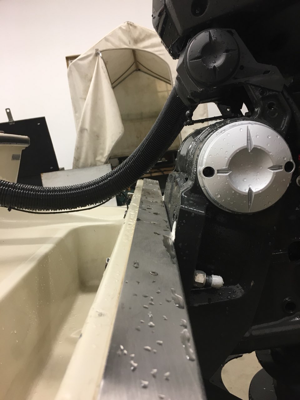

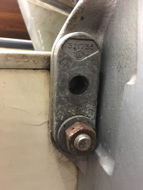

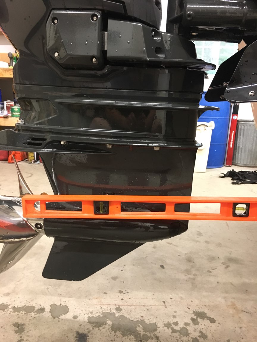

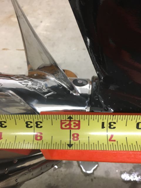

Re: OUTRAGE 22 Whaler Drive, E-TEC G2 225 H.O.
Postby Phil T » Tue Jul 03, 2018 11:16 am
From Bruce:

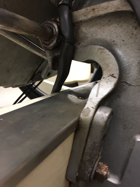

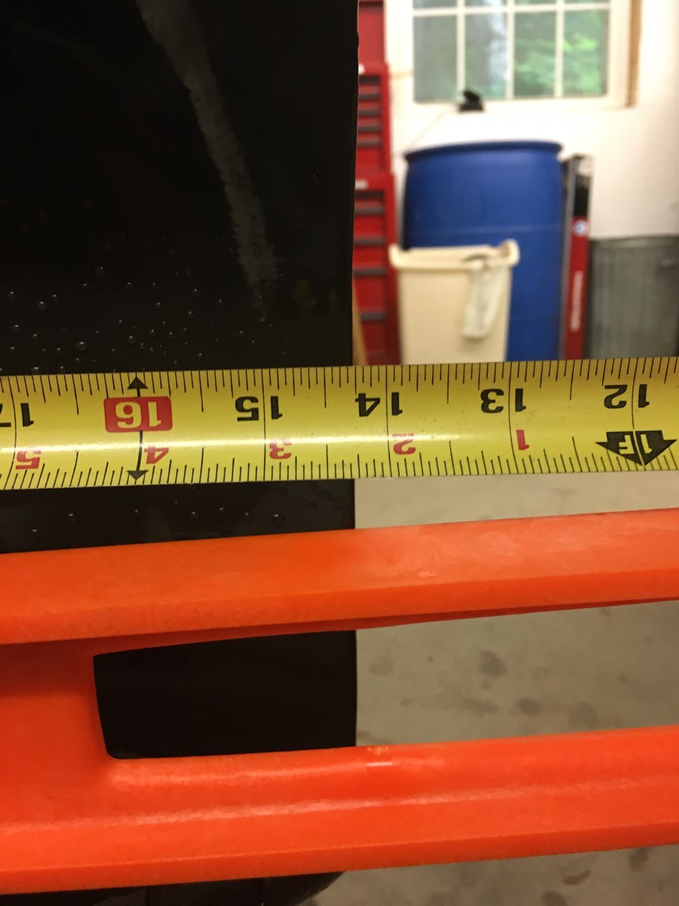

I took a couple comparable pictures to show the difference in the set up and rigging. The pictures of the old motor are during the derigging so some of the cables are messier than usual but the contrast is stark.
Old Mounting:
I also took some pictures with the motor trimmed so that the A/V plate was parallel to the bottom of the whaler drive. In those photos I have a level with the top edge held tight to the bottom of the whaler drive with a floor jack. I took a picture showing the height of the A/V plate elevation above the hull 4.75” also a measurement to the leading edge of the gear case from the transom of the whaler drive 14.25”. And another from the transom of the whaler drive to the leading edge of the prop a little over 31.5”

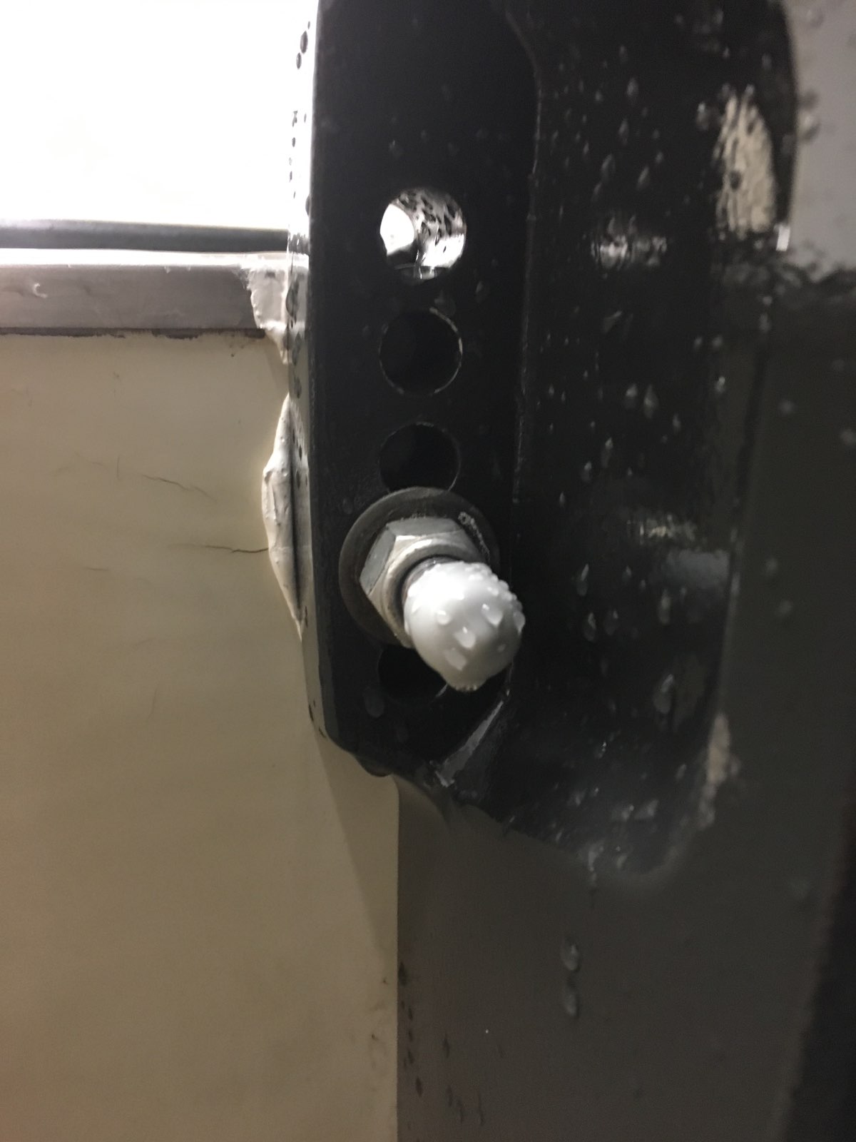

Measurements:
The picture of the mounting bolt pattern did not come out as good as I would have liked it is like this:
O
O
O
O bolt in this hole yes there are 5 holes the top hole in the picture is above the transom you can see light through it!
O

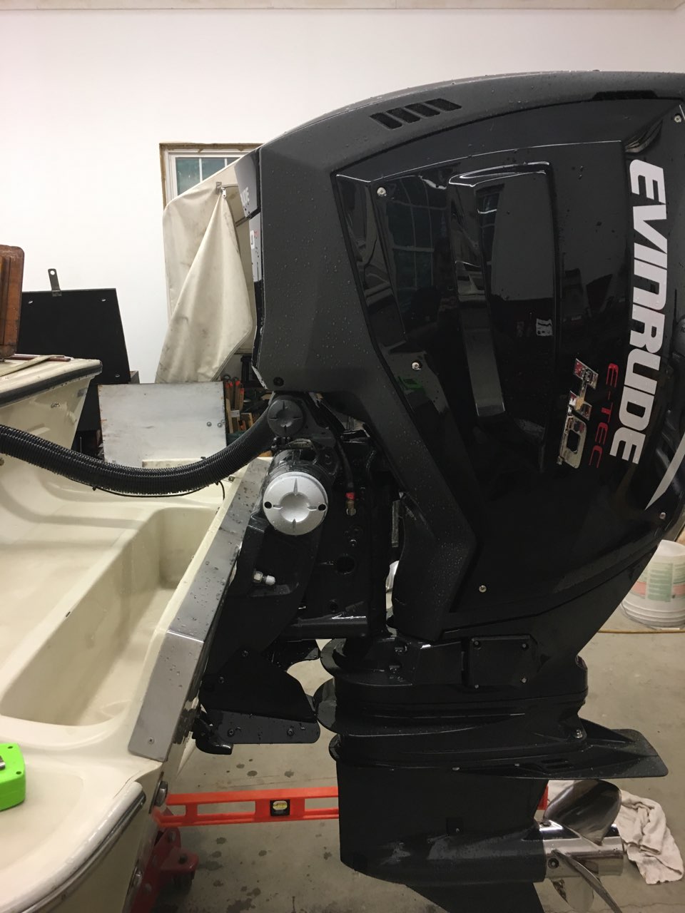

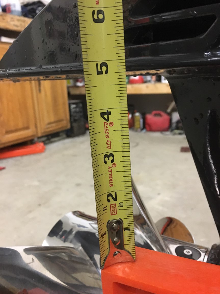

Mounting height:
New Motor - Side view
The motor was a pleasure to drive the DTS and power steering were incredible. Hole shot was amazing and I have the wrong prop ( swapping tomorrow ) to lower pitch. I can’t wait to get this dialed in, already 4 MPH faster and I think there is some room left. I also burned about half the fuel that I normally would on our 4 day camping /fishing trip. I did not take detailed measurements because of the prop swap.

Postby jimh » Thu Jul 05, 2018 9:47 am
The E-TEC G2 225 H.O. engine shown above is mounted three-holes-up on the Outrage 22 Whaler Drive boat.
