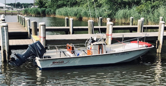

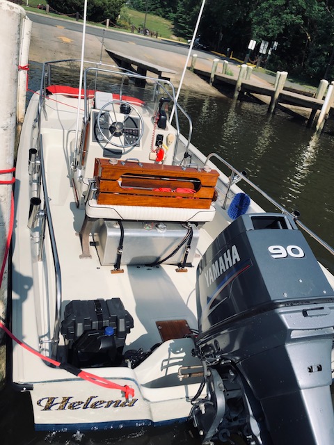

Hi all, I am reaching out for advice on my boat's performance. Here are the data:
1989 17 Montauk
24-gallons Fuel
One Person- 250-lbs
Two Batteries at Stern
2007 Yamaha 90 two-stroke with 230 Hours, Cylinder pressure 125, 122, 120-PSI
Yamaha 17K propeller painted stainless
Engine mounted in lowest position
Boat has bottom paint
Maximum boat speed is 31-MPH.
Max engine speed is 4700-RPM (Factory spec is 4500-5500)
Empty, at rest the boat floats properly
My buddy's 16 Nauset with an older 70 Yamaha comes right on past me.
Do you all have any suggestions?
Thank you,
Fig. 1. The boat under discussion, tied to the dock and seen from astern.
Whaler 1.jpg (125.93 KiB) Viewed 27154 times
Fig. 2. The boat under discussion.
Whaler 3.jpg (111.26 KiB) Viewed 27154 times

Postby jimh » Wed Jul 10, 2019 5:42 pm
As seen in Fig.1. the battery is on Port. Move the battery to Starboard. Propeller torque tends to make the boat lean to Port, and having the battery on Port increases that tendency.

Postby 17MontaukHelena » Wed Jul 10, 2019 6:15 pm
jimh wrote:As seen in Fig.1. the battery is on Port. Move the battery to Starboard. Propeller torque tends to make the boat lean to Port, and having the battery on Port increases that tendency.
There are two batteries. One on the port and one on the starboard side
