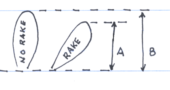

I cannot believe we are still have a discussion about geometry. I will have to make a sketch to explain this to you.
Fig. 1. The same propeller blade, with and without rake, results in different values for the propeller dimension "diameter." For a raked blade, the diameter is 2A. For a nonraked blade, the diameter is 2B, which is clearly going to be larger. Yet the blades are the same length, and have the same blade area.
You cannot discard the notion of a propeller having blade rake when you want to compare blade area by just comparing the diameter dimension. As my sketch shows above, the same blade with a raked mounting produces a smaller diameter dimension. This was exactly what I replied to your comment regarding my comparison of two propellers with different diameters in which I pointed out that the smaller diameter propeller had raked blades, so there was no certainty that it also had less blade area on the basis of a smaller diameter.
Do you "buy" this explanation?

I'll buy that rake can result in a larger blade surface area, but the inscribed circle or DIAMETER is still the same. Your drawing makes no sense.
