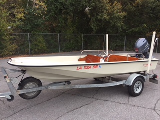

I have a 1985 Sport 15 with a Yamaha F70.
Fig. 1. SPORT 15 on trailer with Yamaha F70
[A SPORT 15 and a Yamaha F70] feels like the perfect match to me. [The SPORT 15] jumps up on step quickly and wide open boat speed is about 43-MPH. I have both a nine-gallon Moeller fuel tank and a starting battery in the stern of the boat. [The SPORT 15] seems to float fine.
