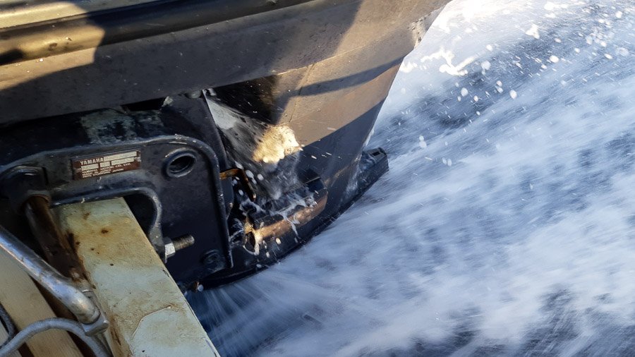

I mount all my engines all the way up and test them. Most stay all the way up or about 2" above the keel.

After raising the motor i verified the correct height by observing the anti ventilation plate on waters surface at planing speeds. The lower set engine caused lots of drag and slowed it down significantly. The 16SL is a great little boat once you get its performance tuned in.

Let's continue talking about engine height. I did check my current engine level yesterday and based on your recommendations it seems really too low. The anti-ventilation plate is clearly below water and there is a lot of water splashing around the engine, that creates lot of drag.
Engine is located one-hole-up [from lowest position] of four possible positions. Shall I raise it by one-hole or two-holes?
[Raising from one-hole up to three-holes up] means mounting at the highest possible levels.
The old Yamaha 90-HP engine accelerates to 5,000-RPM and boat speed is about 31-nautical-miles-per-hour or 36-MPH.
See picture below and video here https://youtu.be/STEg63eexsk

Postby jimh » Mon Sep 14, 2020 6:45 am
Here is a photo of my Yamaha 70-HP engine running on plane.
The A-V plate is more visible than in your image.
How far up the engine mounting can be raised will depend on the propeller is use. In the photo above the propeller was a Yamaha three-blade steel propeller, a standard propeller from them.

Postby WillWhaler » Mon Sep 14, 2020 7:51 am
jimh wrote:Here is a photo of my Yamaha 70-HP engine running on plane...
Thanks Jimh. I have a three-blade propeller, I believe that it's the OEM propeller sold with the engine and looks like aluminium painted in white. As I may replace the engine I will likely not change its mounting height, but the discussion is important for the next engine.
