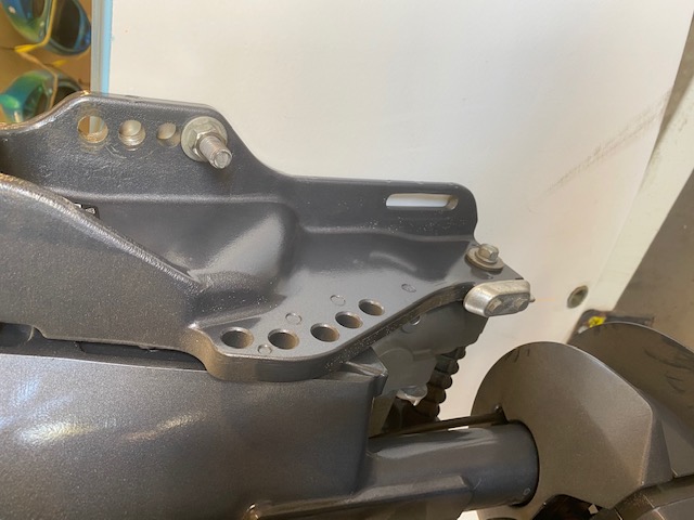

Postby lgdpt » Wed Mar 24, 2021 3:13 pm
Fig. 2. An engine temporarily mounted to a transom using the highest possible mounting position, which for this specific engine is the "three-holes up from lowest position."
Before I drill the lower holes, how many should I drop [the Yamaha F70 engine] down for a Yamaha Performance Series?
Re: NAUSET 16 Yamaha F70
Postby jimh » Thu Mar 25, 2021 5:29 pm
The spacing between the upper set of holes and the lower set of holes is described on another article in PERFORMANCE.
Before you drill the lower pair of holes you need to CAREFULLY READ FOR COMPREHENSION the article at
viewtopic.php?f=7&t=5808
lgdpt
Posts: 16
Joined: Sat Mar 12, 2016 2:14 pm
Postby lgdpt » Fri Mar 26, 2021 11:17 am
Thank you. I read [the linked article on the location of the lower mounting holes when installing engines on boats with shallow splash wells].
[I think] I need to drop [the engine mounting location as shown in Figure 2 above by] one hole and drill there.
I will read [the linked article on the location of the lower mounting holes when installing engines on boats with shallow splash wells] one more time to confirm.
Postby Phil T » Fri Mar 26, 2021 11:41 am
Please STOP confusing the hole location with the actual position of the motor.
The motor position should NOT be taken into account.
Get a measuring tape and MEASURE the holes. Look at the DIAGRAM with the distances and then measure to the locate the lower hole location. Mark it, then drill.
If it is easier, REMOVE THE ENGINE, measure, mark, drill.
Once holes are drilled, THEN you adjust the engine.
Postby jimh » Fri Mar 26, 2021 12:05 pm
The article on the location of the lower mounting holes when installing engines on boats with shallow splash wells describes how to position the lower mounting holes on boats that have a shallow engine splash well. A NAUSET 16 boat has a shallow engine splash well.
The article on the location of the lower mounting holes when installing engines on boats with shallow splash wells describes only two recommended locations for the lower mounting holes for use on boats with shallow engine splash wells.
I recommend you re-read the article on the location of the lower mounting holes when installing engines on boats with shallow splash wells and pay more attention to the purpose of the article. The article has nothing to do with where the engine will eventually be mounted to the transom in terms of the engine mounting height. The article only describes where to locate the lower engine mounting holes on boats with shallow engine splash wells so that the inboard end of the holes will be above the engine splash well.
It appears you have already drilled the upper set of holes. It appears you have located them at or very close to the BIA recommended position. You should now follow the advice in the linked article regarding where to drill the lower holes.
In the simplest terms, there are only two options for you: the location shown in yellow or the location shown in green.
YOU NEED TO CAREFULLY READ THE TWO PARAGRAPHS THAT BEGIN WITH "If the lower pair of transom holes is spaced ..."
The article makes the choice of which hole to use abundantly clear. PLEASE READ THE ARTICLE AGAIN. The article has been carefully written to provide ALL the information you need to make a choice of lower engine mounting hole location on boats with shallow engine splash wells.
lgdpt
Posts: 16
Postby lgdpt » Fri Mar 26, 2021 12:26 pm
I drilled the top holes based on measurements.
The Yamaha F70 outboard engine was no near me when I did that.
Then I lined-up it and took the picture to see how it lined up. It is off and ready for the lower hole to be drilled.
Postby jimh » Fri Mar 26, 2021 2:30 pm
lgdpt wrote:Then I lined-up it and took the picture to see how it lined up. It is off and ready for the lower hole to be drilled.
What does "it" refer to in the three different places that pronoun is used in your two sentences above? I don't understand your meaning.
Generally when a process of alignment has occurred (as in "lined-up") there are two objects involved. The two objects are positioned in some sort of alignment and then are said to be "lined up."
What are the two objects you refer to? What was their alignment position?
