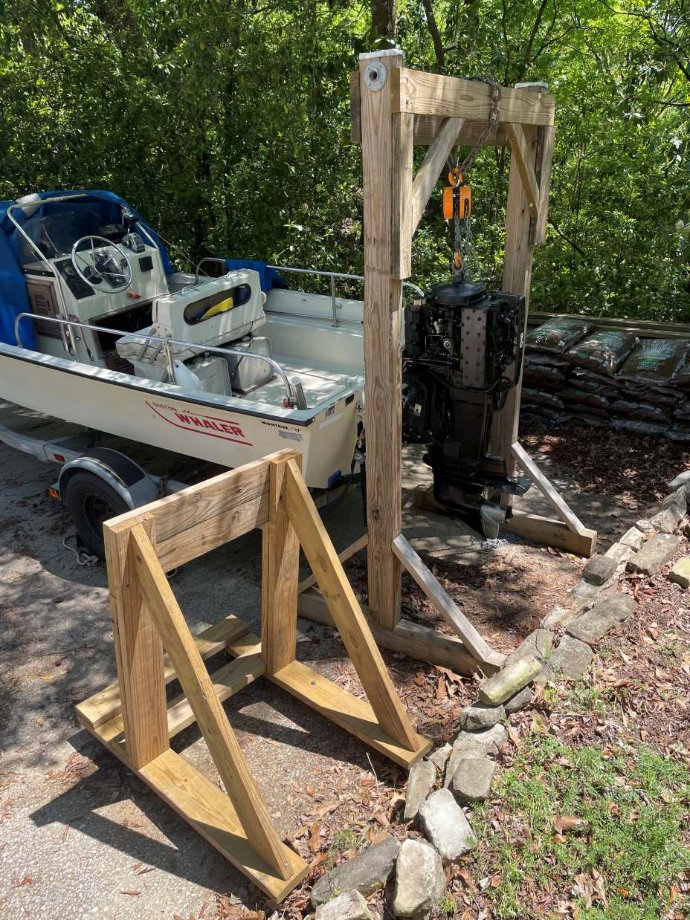

Next, I removed the battery cables, wiring harness, and shift/throttle controls, and pulled off the motor.

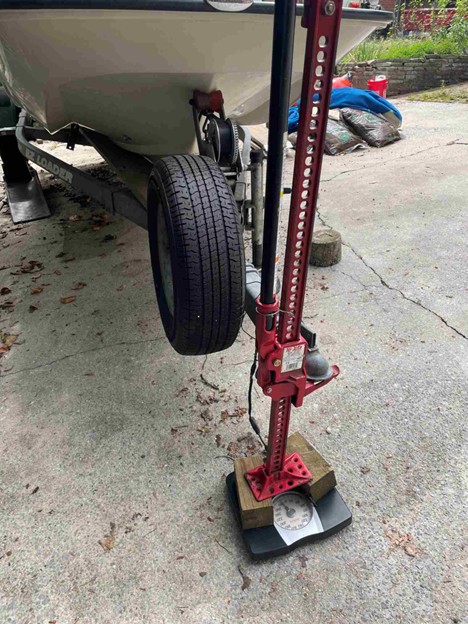

Figure 1. Engine removal using my repurposed chin-up bar. I already had a motor stand that I had built using leftover boards from a deck project, so the process was straightforward.
Figure 1. Montauk 17 outboard motor removal.jpg (226.43 KiB) Viewed 15625 times

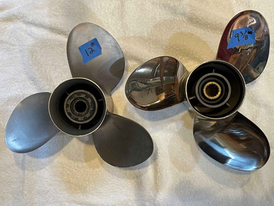

In the end, I bought a new-in-box Yamaha Performance Series-3 13.25-inch x 14-pitch propeller from a marine supply store in Maine that listed three for sale on eBay. It’s a beautiful propeller, highly polished (although that isn’t supposed to affect performance), with one characteristic that I’ve never seen mentioned: it is quite light, at least when compared to my old propeller (See Figure 2).
Figure 2. Quicksilver 13” x 19” vs Yamaha Performance Series-3 13.25” x 14”. Weights as shown.
BW prop pic 5-23-25.jpg (135.53 KiB) Viewed 14498 times

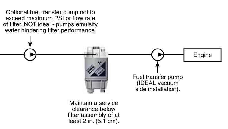

I was intrigued by this comment since I have been a Racor customer for more than 30 years and had never encountered this instruction. I searched the manufacturer’s website and reviewed their extensive (888 pages!) online catalog , which contains detailed information about all their filters, including installation instructions and diagrams. The term “primer bulb” does not appear in this document; however, Racor markets filters that incorporate built-in priming pumps, like this one. These priming pumps are on the upstream side of the filter, meaning they pump fuel from the tank into the filter.
Note the following Racor installation diagram:
Figure 4. Racor filter installation diagram. (The service clearance specified for my filter is only 1 inch.)
Racor installation diagram.jpg (80 KiB) Viewed 14187 times
Perhaps this controversy about primer bulb placement exists because Racor recommends that fuel transfer pumps be downstream of the filter to avoid emulsification of water with fuel. Given that fuel transfer pumps aren’t the same as primer bulbs and Racor markets priming pumps that are upstream of its filters, I think one can safely install a primer bulb either upstream or downstream of the fuel filter. Here is what my fuel system looks like now:

Regarding damage to a fuel filter from over-pressurization by an upstream primer bulb, Racor cautions against pressures above what is rated for the filter, which in my case is 7 psi. Can a primer bulb exceed this pressure? Having some pressure gauges and fittings previously used on other projects, I decided to find out. I hooked up a primer bulb to about one foot of fuel line with a pressure gauge and a ball valve on the other end. When I pumped up the system with air, I couldn’t get more than about 0.5 psi, but when I filled the system with water, the pressure immediately rose on pumping, with the bulb becoming firm at 3 to 4 psi. If I were preparing the engine to run, I would have stopped pumping at this point. I could get the pressure up to 18 psi, but only with a very vigorous effort that I would not have been able to achieve on a boat. Keep in mind that this was a worst-case scenario, with a short run of tubing and pumping against a closed valve. I’m comfortable that I won’t be damaging my filter by using an upstream primer bulb. (By the way, even if you have a primer bulb downstream of your external fuel filter, you are still upstream of the filter under the cowling.)

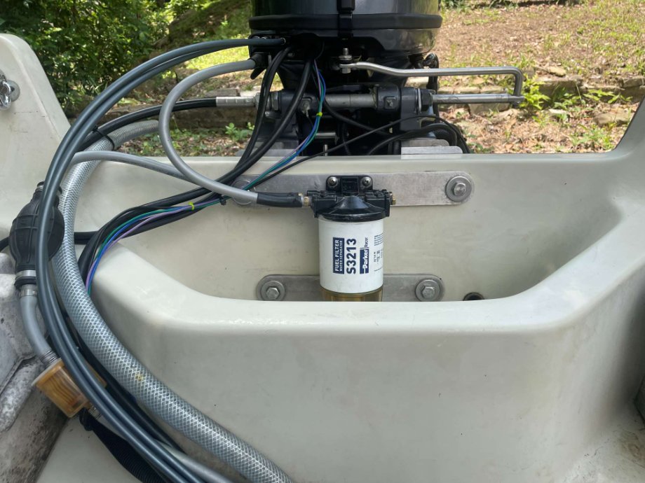

After years of struggling with fuel hoses obtained at the local sporting goods store, I purchased a Quicksilver 8M0061890 Fuel Line Assembly - 9 Ft. Long with Primer Bulb. Pricey, but money well spent, as the liner doesn’t separate from the rubber when a fitting is inserted, unlike the aftermarket lines I have encountered. I’ve used the Quicksilver assembly for over two years, and it’s holding up well.
I chose to rig my fuel assembly so the primer bulb could be easily held vertically while being pumped; if I were to have installed it after the filter, I would have needed an extra foot or so of fuel line to achieve that. I suspect that boat manufacturers have to deal with many challenges when they rig their boats, including economy of supplies and ease of installation, and I respect them for that, but sometimes their rigging can be improved upon. In lieu of advice from the engine manufacturer, I think the most reliable information about whether the primer bulb can be located before the filter would be obtained by asking the filter manufacturer, and someone seems to have done just that.

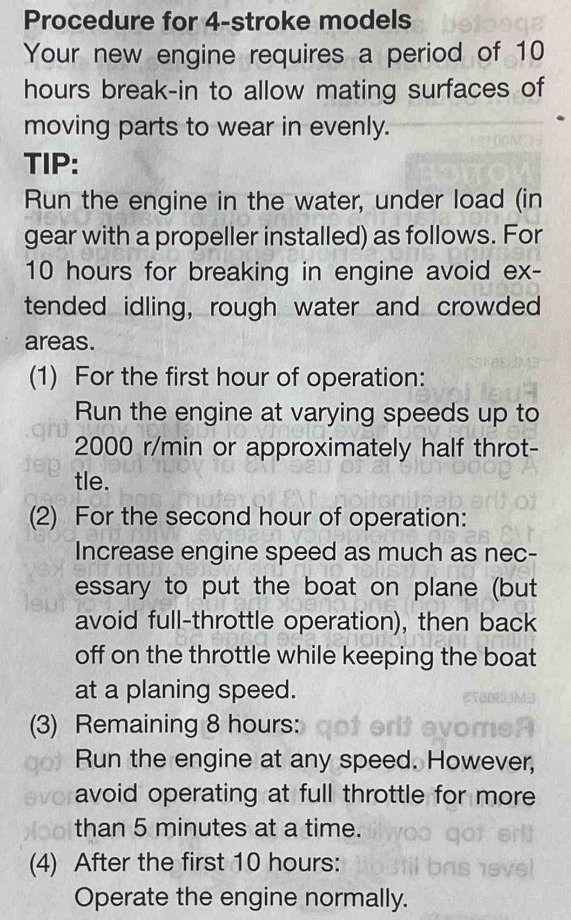

PART FOUR: ENGINE BREAK-IN
When I took delivery of the boat, I received two sets of break-in instructions. Here is the one in the owner’s manual:
Figure . Break-in instructions in Yamaha F70 owner’s manual.
F70 factory break-in procedure.jpg (145.38 KiB) Viewed 14059 times

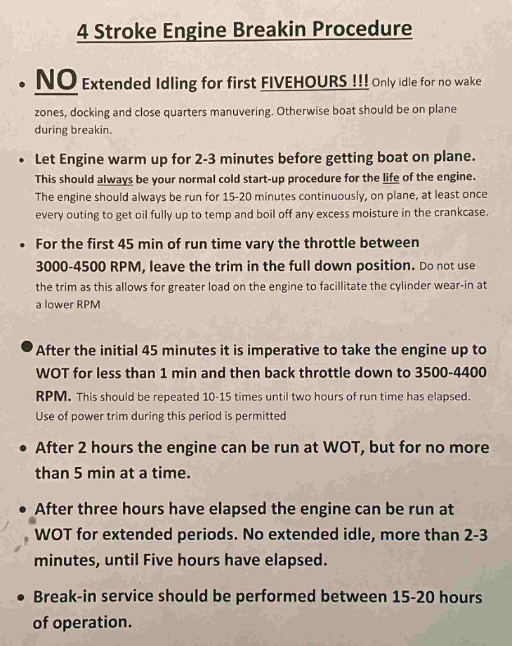

And here is what I received from the dealer:
Figure . Break-in instructions from the dealer, Fredrick Outdoor, Decatur, Alabama.
F70 dealer break-in procedure.jpg (144.49 KiB) Viewed 14059 times
Note that the manufacturer recommends avoiding wide-open throttle use during the second hour of the break-in, while the dealer strongly recommends it. I reconciled the two sets as best I could and started the sea trial after two hours.

The elaborate regimen for engine use during "break-in" seems to be something that has occurred with marine outboard engines using four-stroke-power-cycle designs. For perhaps 100-years four-stroke-power-cycle engines have been used in automobiles, and I do not recall any special conditions imposed for engine speeds in their initial use. I do recognize that marine outboard engine are generally operated at higher power outputs for a greater percent of their operating time than automobile engines will encounter--unless driven be teenagers.
Q1: do you have any speculation why your Yamaha outboard engine manufacturer and dealer both set out specific guidelines for "break-in" operation?
Posts: 1801
Re: Re-powering the Montauk 17 in 2025: an Illustrated Narrative
Postby Jefecinco » Tue Jun 10, 2025 9:52 am
Our 2025 Honda CRV hybrid has a recommended 600 mile break-in procedure. I won't go into the details but the recommendation is to avoid full throttle acceleration, hard breaking, etc. The recommendation is supposedly due to the high output to displacement ratio of most newer engines.
Postby jimh » Tue Jun 10, 2025 10:26 am
Jefecinco wrote:Our 2025 Honda CRV hybrid has a recommended 600 mile break-in procedure. I won't go into the details but the recommendation is to avoid full throttle acceleration, hard breaking, etc. The recommendation is supposedly due to the high output to displacement ratio of most newer engines.
Thanks for that input. Perhaps the need for specific operating speed during break-in is becoming more common in automotive engines.

When I hooked up the trailer to take the boat out for a spin in the lake before heading for my annual Louisiana fishing trip, I noticed that the tongue weight was much heavier than before the repower. I have an EZ Loader adjustable trailer, and a few years ago I had adjusted it so that the transom is directly over the rear rollers while maintaining the tongue weight at about 175 pounds. Since the recent repower, the tongue weight is 260 pounds.
Figure 7. Tongue weight measurement using a bathroom scale and a Hi-Lift jack. The jack weighs about 30 lbs. The initial reading gave a tongue weight of 260 lbs. No wonder I had trouble lifting it.

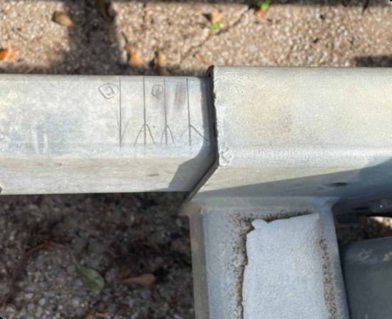

I believe the definitive treatise for calculating the trailer setup to achieve a specified tongue weight is an article on ContinuousWave (see here), but I just did it empirically by suspending the trailer on concrete blocks, loosening the bolts that secured the axle, moving the axle by tapping the supports with a hammer and block of wood, re-tightening the bolts, removing the blocks, checking the tongue weight, and repeating the process until I achieved the desired tongue weight. This may sound tedious, but it was actually easy to do. With both 11-gallon fuel tanks full and two batteries, I estimated that my gross weight is about 2,000 pounds. I wanted a tongue weight between 5 to 10% of the gross weight, or 100 to 200-lbs.
Figure 8. Reference marks to track how the location of the axle assembly was changed.
I added a 42-lbs bucket of kitty litter at the transom to approximate the weight of the second battery with which I usually cruise. Moving the axle assembly forward 5-inches yielded a tongue weight of 185-lbs--close enough.
--M

Postby jimh » Mon Aug 11, 2025 9:56 am
If your estimated total weight of 2,000-lbs is correct, and your measured trailer tongue weight is accurate, then the amount of tongue weight as a percentage of total towed weigh is then 180/2000 = 0.90 or 9-percent.
The previous tongue weight of 260-lbs was 260/2000 = 0.13 or 13-percent.
When part of the towed trailer weight is transferred to the hitch of the towing vehicle as tongue weight, most of that weight is transferred onto the rear axle of the towing vehicle. There may also simultaneously be a reduction of weight on the front wheels of the towing vehicle. By reducing tongue weight, you most likely also reduced the weight on the rear axle of the towing vehicle while perhaps also increasing somewhat the weight on the front axle, compared to those weights with the higher tongue weight.
If the towing vehicle is a front-wheel drive, losing weight on that axle can reduce traction and affect steering. So decreasing tongue weight can help avoid those problems.
ASIDE: on my rear-wheel drive 1995 GMC Suburban the recommend tire pressure for the front wheels is lower than for the rear wheels, which I believe is done to maintain better contact with the road surface for the front tires and improve steering.

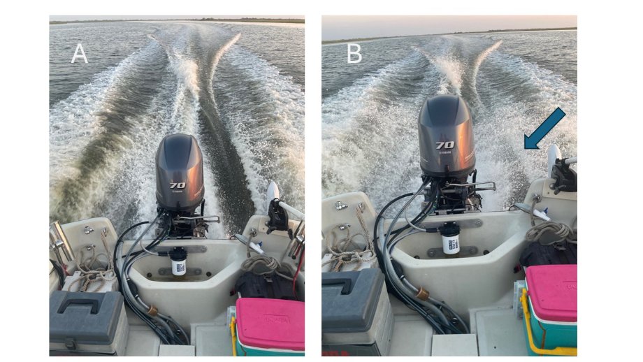

One interesting phenomenon observed during this trip was how the boat wake changed as the engine was raised while underway. In Figure 10, the photo on the left (marked A) shows the engine trimed with the anti-ventilation plate just below the water surface. In the photo on the right (marked B) the engine is trimmed is one inch higher, with the anti-ventilation plate now about a half-inch above the water surface. Note that raising the anti-ventilation plate above the surface of the water results in water spraying out laterally from the lower unit. This would seem to be a convenient way to confirm the height of the anti-ventilation plate from the helm. I didn’t notice any change in performance when doing this, but the exhaust noise got a bit louder.
Figure 10. A: Motor running with anti-ventilation plate just below the water surface. B: Motor raised so that anti-ventilation plate is about ½ inch above the water surface, with resulting change in the boat wake (arrow).
BW wakes August 2025.jpg (100.17 KiB) Viewed 11689 times

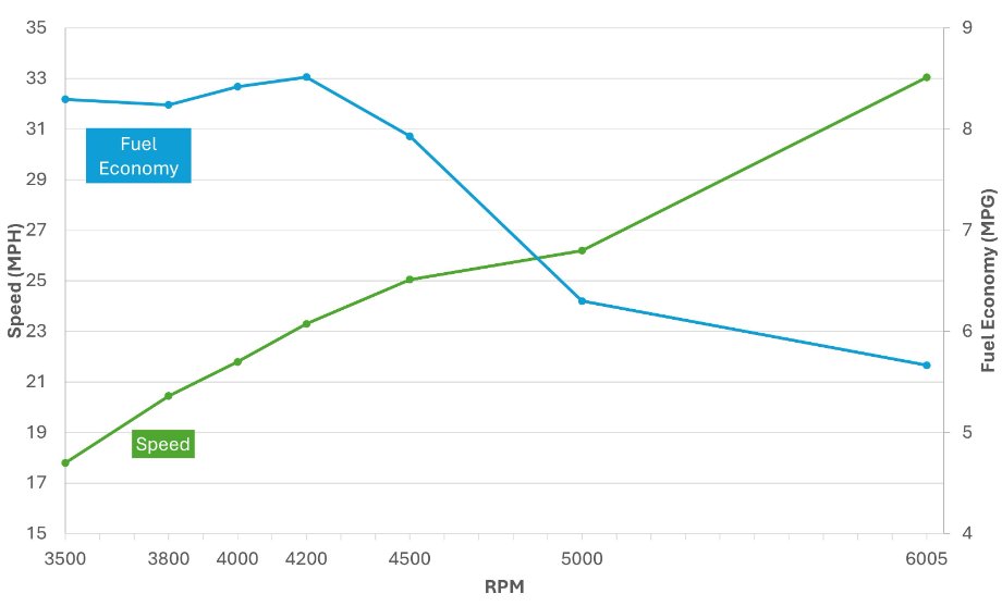

A few months ago I installed a Garmin ECHOMAP UHD2 93sv connected to the engine via an NMEA 2000 network (you can read the details of how I accomplished this here: https://continuouswave.com/forum/viewto ... =9&t=10083). This allowed me to assess fuel efficiency, as shown in this graph:
Figure 11. Performance chart for 1990 Montauk 17 with 2024 Yamaha F70LA engine. Data obtained 23 June 2026; Smith Lake, Alabama, elevation 510 feet MSL, air temperature 81F, wind speed 5 MPH. Fuel 22 gallons, two 44-lb batteries; one person on board (195 lbs). Ventilation plate skimming water surface on plane; neutral trim.
F70 Montauk 17 performance chart low rez.jpg (38.65 KiB) Viewed 7451 times
These performance curves closely match those published by Yamaha for a boat of similar weight and hull design, the Avid 18 XB, outfitted with a Yamaha F70 and a Talon SS 13-1/8 x 14 propeller (see here: https://yamahaoutboards.com/outboards/1 ... -27-20_alm). A recent fishing trip gave me another chance to evaluate boat performance. I found that in calm water, I could obtain an additional 0.5 MPG by raising the engine so that the ventilation plate was about 2 inches above the water surface.
