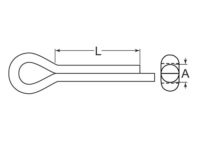

Regarding cotter pin dimensions, the 1/8-inch value is the distance across the pins themselves when the pins are held tightly together. The 1-1/2-inch value is the distance of the shorter pin, measured from the end of the pin to beginning of the bend for the eye at the other end. I carefully measured an OEM cotter pin and determined to my own satisfaction that it was, indeed, a 1/8-inch x 1-1/2-inch cotter pin.
Fig. 2. A dimensional drawing for measurements of cotter pins.

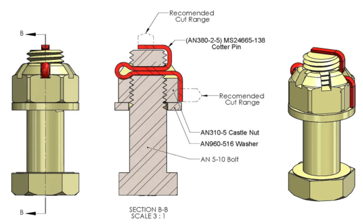

The FAA recognizes one preferred method of installing cotter pins as covered here. There are some optional methods when space does not allow for the preferred method and those optional methods can be found in AC43.13-1.
First and foremost the cotter pin must be of the correct size. If not called out, a good rule of thumb is the 2/3rds of the hole diameter but in any case the cotter pin should fit neatly into the hole, with very little side play.
If you look closely at a cotter pin you will notice it has a long leg and a shorter leg. The long leg is intended to go over the top of the bolt or fastener and the short leg along-side the nut.
1. Insert the cotter pin with the long leg on top.
2. Seat the bulbed end of the cotter pin securely into the nut and bolt.
3. Using duck-billed or needle nosed pliers, grab hold of the upper leg and in one fluid motion bend to a vertical position.
4. Using side-angle cutters (dikes- to most of us) trim the short leg so as not to cut into the structure when bent.
5. Bend the short leg down vertically along-side the nut.
6. Using your dikes trim the remaining long leg so it will lay 1/2 to 3/4 across the end of the protruding bolt or fastener.
7. Bend the remaining leg over top of the bolt or fastener ensuring it is flush so as not to become a snag.
Here are some general rules that can help you in installing and inspecting your cotter pin installation.
a. The prong leg bent down should not rest against the surface structure or washer.
b. Never reuse a removed cotter pin, use a new cotter pin at each installation.
c. If you mess up on the installation, remove the cotter pin and give it another go until it is installed correctly.
d. The prong leg bent over the bolt end should not extend beyond the bolt diameter. This can cause a snag and injure you or someone else.
e. All prongs should be bent over a reasonable radius. Sharp-angled bends can cause breakage. Lightly tapping with a light mallet can assist you in bending the prong legs on larger diameter cotter pins.
Fig. 3. Cotter pin installation on castle nut as used in aircraft fasteners.
COTTER PIN.PNG (219.26 KiB) Viewed 19560 times
Note that the upper arm of the pin does not extend beyond the diameter of the bolt, and the lower arm does not touch the washer or surface of the object being fastened. Also, in marine applications (even freshwater) all fasteners should be of a high grade of stainless steel. High grade stainless fasteners are available at many ACE Hardware stores, and on-line at Graingers and Amazon.

The solution used in aviation applications appears to be a good one. However, it seems only appropriate to a castle or crenelated nut. Some, if not all, propeller nuts requiring a cotter pin are probably castle nuts. Many others are not. Thanks for the information.

I like the orientation of the eye of the cotter pin as seen above in Figure 3. The cotter pin eye is oriented in-line with the propeller shaft. I think that is how the master mechanic Doug at my Evinrude dealer installs them.

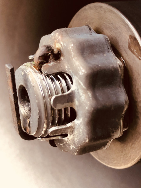

I recently installed a new propeller on the engine propeller shaft, and I used an alternate method for the cotter pin installation. I illustrate the technique below in Figure 4.
Fig. 4. Cotter pin installation with the orientation of the cotter pin bends in-line with the propeller shaft.
IMG_4552 (1).jpg (49.82 KiB) Viewed 19373 times
As shown above, the shorter pin was bent about 180-degrees and folded over the end of the propeller shaft. The longer pin was then cut-to-length so that it would make a nice 90-degree bend and be a flush fit onto the end of the spacer. This method produced a better fit of the keeper washer onto the propeller nut. There is no looseness in the fit of the keeper washer, and the cotter pin head is nicely wedged into the opening in the propeller shaft.

The method you used certainly looks very professional. It may not do the job better but it's always satisfying to do professional looking work. I like it.

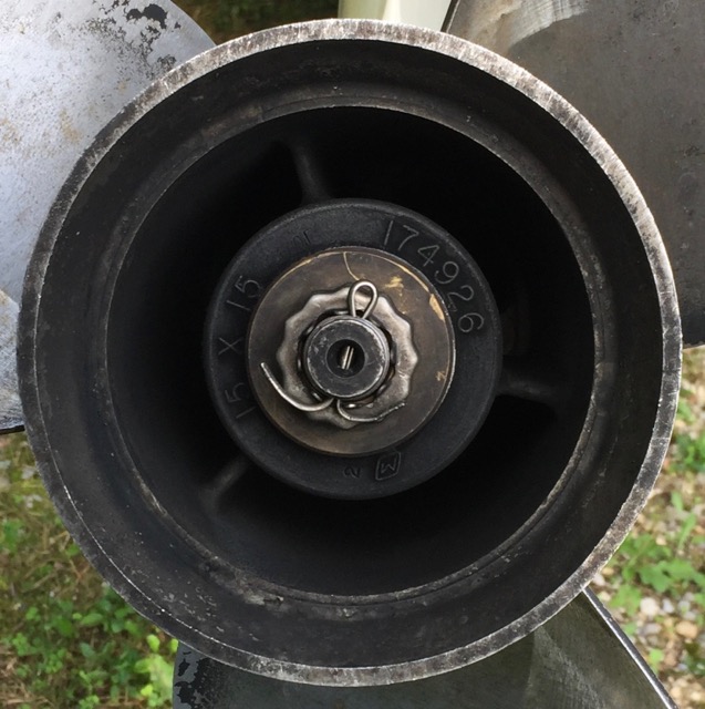

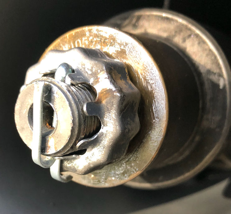

FOLLOW UP on Cotter Pin Installation
In the process of doing some work on my E-TEC 225-HP engine, I took a careful look at the cotter pin that holds the "keeper" fitting in place over the propeller nut. I installed this particular cotter pin in 2021, and after five years in service it was looking a bit suspect. As seen in Figure 6, the keeper was cutting a notch into the cotter pin. Not wanting to loose any parts from the propeller shaft, including possibly a $600 propeller, I decided to replace the cotter pin.
Fig. 6. The cotter pin at age 5, after removing soot. There is wear on the pin and some rust forming.
As I mention in the initial article in this thread, the source of the existing cotter pin was from a local hardware store, and it was NOT stainless steel. There was some rust forming on it. The boat has only been in freshwater, and really only a ridiculously small number of days each year, but in the summer it sits outdoors, where the propeller can get wet from morning dew and from me spraying off all the damn bugs that land on the boat and die every night. Typically I am rinsing off the stern of the boat almost every morning. The boat then sits in the sun all day. So you have steel, water, air, and some heat, perhaps a good recipe to promote rust.
Also, in my article above I commented on how firmly the keeper and the pin were being retained, but five years later this was no longer true. The keeper had quite a range of wiggle room, probably associated with how it was cutting a groove into the cotter pin.
As part of that process or servicing the cotter pin, I scrubbed off a lot of soot from the keeper, the propeller nut, and the brass propeller adaptor fitting. As you can see, the part number embossed on the brass fitting returned to be visible again. I also removed the propeller and re-greased the propeller shaft splines and the thrust bearing.
Then I reinstalled the propeller, and torqued the propeller retaining nut to about 65 to 70-ft-lbs, (the service manual specification is 70 to 80-ft-lb) using my quite ancient Sears Craftsman torque wrench, the type with a long pointer indicator that gives the torque reading from a companion ruler-scale and a long handle to produce the necessary torque, (and thus not the more modern digit torque wrench in common use today).

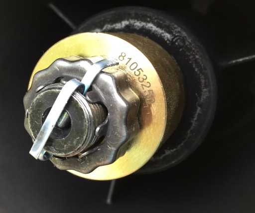

Then the keeper gizmo was put into position and a new cotter pin installed. I am quite sure the new cotter pin was one of several in a small plastic bag that I bought a few years ago from my Evinrude dealer using the official Evinrude part number, and I hope were all stainless steel.
The new installation is shown in Figure 7.
Fig. 7. The replacement cotter pin, installed September 22, 2026. I also scrubbed the soot off the brass adaptor fitting and the keeper.
Again, at the time of installation the cotter pin was holding the keeper in a firm position. Perhaps in five more years I can update how this cotter pin survived. If there is a repeat of the keeper cutting into the cotter pin, I think I will revert to the more traditional method of installing the cotter pin as shown in Figure 5 above. Also, I will forever more to be sure to use stainless steel cotter pins.

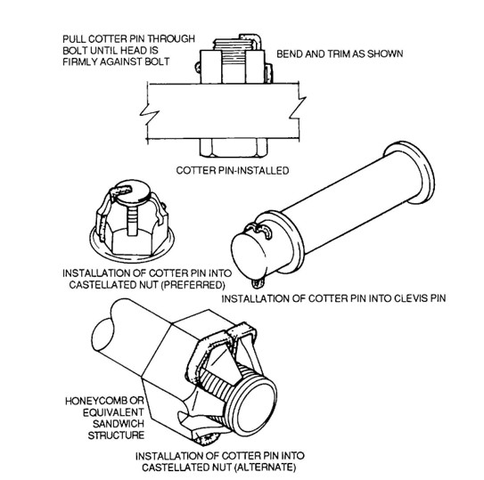

I was interested in this discussion because I recently replaced my outboard motor of thirty-five years whose prop nut was secured with a tab washer with one (a Yamaha F70) that uses a cotter pin. When I installed the propeller on the new engine, I simply inserted the pin and bent back the tangs as shown in Figure 5, not realizing there are other options for pin installation, as shown in Figure 8.
Figure 8. Cotter Pin Installation. Army tech manual TM 1-1500-204-23-6 on General Aircraft Maintenance.
Milspec cotter pin installation.jpg (52.3 KiB) Viewed 905 times

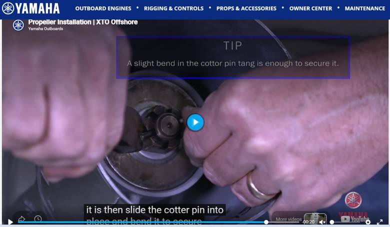

However, Yamaha recommends another method as shown in Figure 9, a screen shot taken from a Yamaha instructional video (watch it here: https://yamahaoutboards.com/owner-cente ... o-offshore).
Figure 9. Screen shot from Yamaha instructional video on propeller installation. Note the TIP: “A slight bend in the cottor (sic) pin tang is enough to secure it.”
Cotter pin install Yamaha.jpg (69.41 KiB) Viewed 905 times
