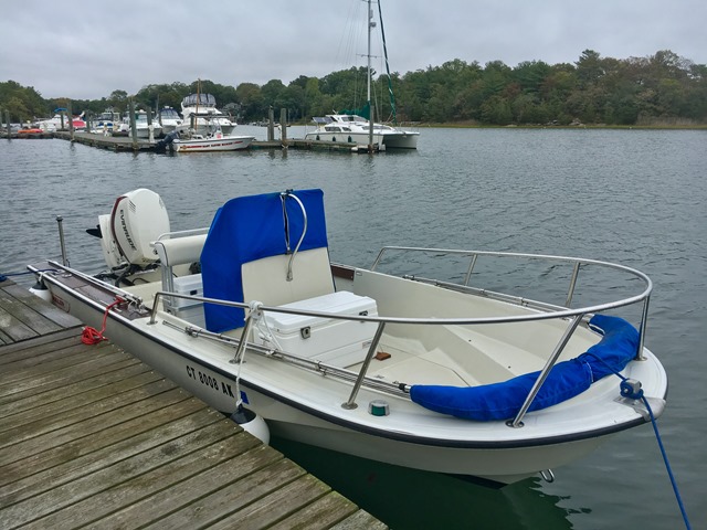

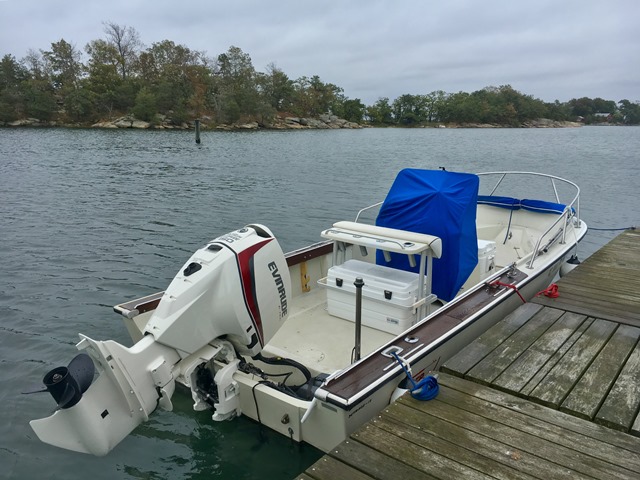

Thanks, both, for your replies and apologies for the delay. After tinkering a bit further, I decided now was a good time to just repower with a new 150 E-TEC G1. BRP had a decent promotion and I got a pretty good price from my local dealer. I chose not to go with the "H.O." model because the specs are identical at the 150 hp level and no one could give me a good enough reason to do otherwise. I also chose not to go with the G2 because it's a bit heavier, due largely to the new mounting bracket (which apparently can be swapped out for the traditional bracket), and I just couldn't envision it aesthetically sitting on my transom. I chose the standard analog gauges, but added a SIMRAD NNS7 evo2 connected to the motor via a NMEA 2000 backbone for digital details.
So far top speed is 44-45 mph (GPS) with standard 14.25x17" aluminum prop, 60 gallons of gas (370 lbs.), general gear (about 100 lbs.), and one operator (about 160 lbs.). I am also still in the initial phase where the motor really drinks up the XD-100, so the gasoline:oil ratio should improve. My time to plane can be measured in fractions of a second. The motor is mounted one hole up, which seems okay with this prop, especially in higher-speed turns when trimmed out, but suggestions as to re-mounting and re-propping are welcome. It is very, very quiet at idle. I've used it for only a few hours, but so far I am very pleased with the performance of this motor.

Postby jimh » Mon Oct 03, 2016 4:00 pm
Thanks for the update and the images of the new E-TEC 150-HP engine on the classic OUTRAGE 18 boat. The two look very good together, and your performance information indicates the two work very well together.

Posts: 13290
ASIDE: photo shows good location for fender
Postby jimh » Wed Oct 05, 2016 11:56 am
Also note the position of the forward fender; it is in just the right place for a classic hull.

Postby Spinnaker » Fri Oct 07, 2016 11:47 am
Thanks for the kind remarks and advice on prop selection. I am going to go stainless for next season, and will keep the current prop on board as a spare. I have been considering the Rebel and the Viper. The forward fender is attached to the bow railing using a Taylor Made Rail Fender Hanger, purchased at West Marine, which so far has worked well.

Re: Outrage 18 with 1989 Johnson 120; E-TEC 150-HP Re-power
Postby Phil T » Mon Oct 17, 2016 9:45 am
Appears the motor can be raised at least 1 if not 2 holes.
The consensus from Boston Whaler owners mounting E-TEC outboard engines is to mount them as high as practical.
