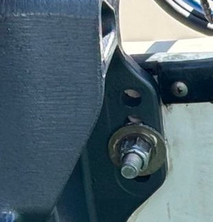

Engine mounting height: [Moderator's note: please always describe engine mounting height as the number of holes the engine has been raised from lowest position. In this case, from Figure 1 we can see the engine is mounted two-holes-up.]
Fig. 1. Engine mounting height shown as "two-holes-up" from lowest position.
