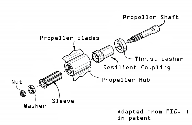

Evinrude has patented their invention of an "Axial Twist Propeller Hub" under United States Patent 6383042, which can be retrieved from
http://pdfpiw.uspto.gov/.piw?Docid=06383042&homeurl=http%3A%2F%2Fpatft.uspto.gov%2Fnetacgi%2Fnph-Parser%3FSect1%3DPTO1%2526Sect2%3DHITOFF%2526d%3DPALL%2526p%3D1%2526u%3D%25252Fnetahtml%25252FPTO%25252Fsrchnum.htm%2526r%3D1%2526f%3DG%2526l%3D50%2526s1%3D6383042.PN.%2526OS%3DPN%2F6383042%2526RS%3DPN%2F6383042l&PageNum=&Rtype=&SectionNum=&idkey=NONE&Input=View+first+page
The invention shown in the patent linked above appears to be extremely similar to the TBX bushing or hub kit, as can be seen from this drawing from the patent (to which I have added text callouts instead of numbered callouts):
Adapted from FIG. 4 of patent
One of the claims made in the patent is that the patented invention provides for a "limp home mode" of coupling between the propeller shaft and the propeller that will continue to allow operation even if the propeller has struck some underwater object and the plastic coupling has yielded as intended. Details of this are given in the text of the patent. The patent was issued in 2002. I believe that the first time the TBX hub kit was available was c.2007.

In some recent correspondence with BRP, they confirmed that their torsion bushing extreme or TBX hub does incorporate a limp-home mode of operation. If the plastic of the resilient coupling yields under extreme loads, a low-torque coupling between propeller shaft and hub will remain. This will allow the propeller to turn under low-torque conditions and provide a "limp-home" mode of operation following a severe propeller strike.
